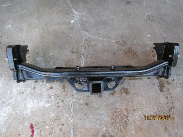

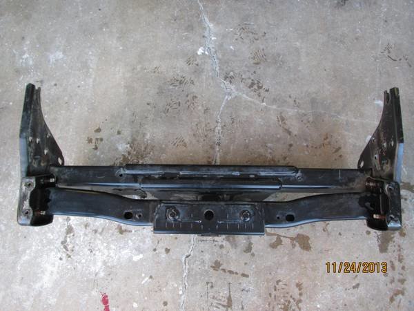

    i just both one from craigslist for my truck sr5 2014 no towing package... for 120... used but still good shape...
