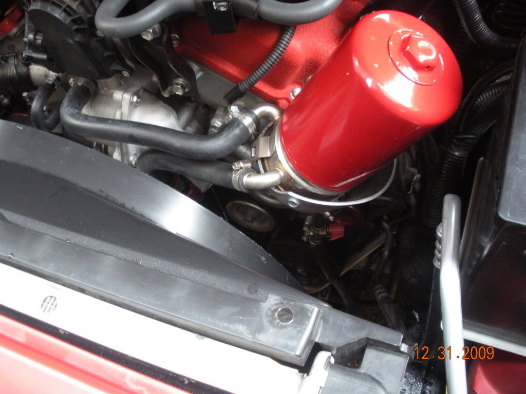

    Sorry, there will be a smaller, secondary radiator in front of the main one. There will also be 2 lines just below the oil filter that are for the supplimental engine oil cooling.
    Engine oil cooling lines:
    Secondary radiator:

    And we have a winner! :)
    I have the coolers shown. That gives me a lot more confidence that I can haul my 29 Model A pickup around without overloading the Taco, since the A only weighs about 2300 pounds.:D
