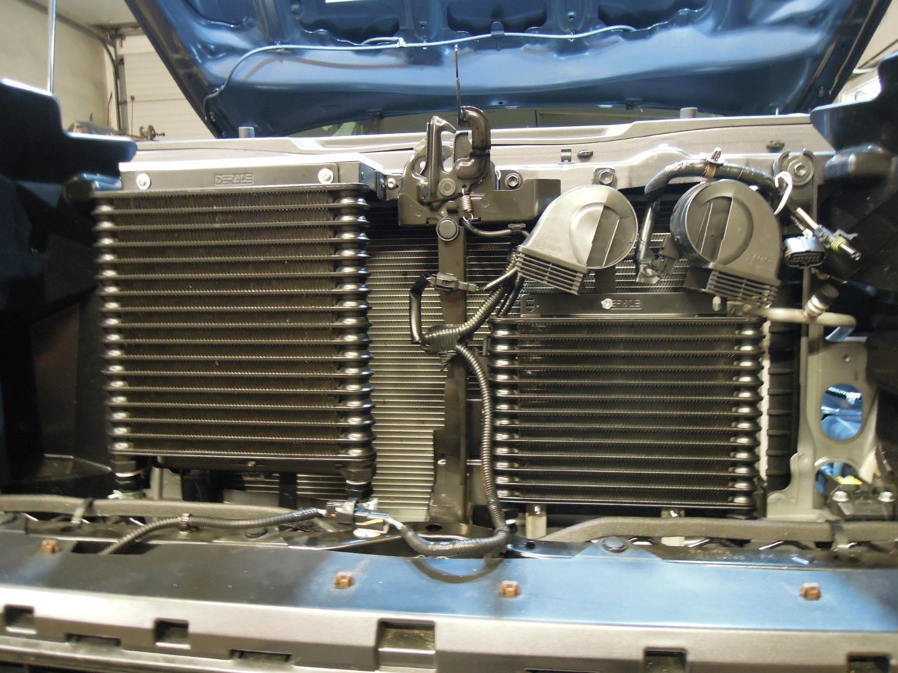

    I'm a big fan of transmission coolers. There is plenty of room for them.

    Which cooler is that? Are they BOTH tranny or is one an Oil Cooler? How was the install and most of all, how tough was the proper balancing of the added trans fluid with these very precise tranny fills we have to maintain?

    Both coolers are for the transmission. All metal plumbing to very short rubber hose connections at the coolers. I added trans fluid and set the level as per the instructions on the forum. Probably added about a quart. Regards

    what are those two things on top right?

    Horns

    Chew is right. I monitored mine and went from 225 degrees to under 150. I have yet to reach 200 even on the mountain hills to my trailer.
