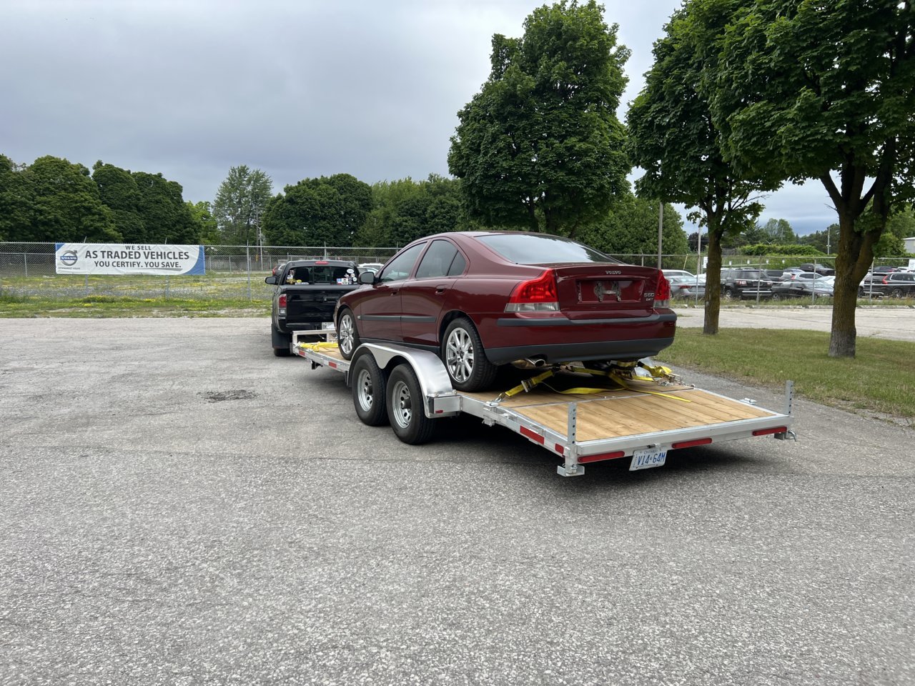

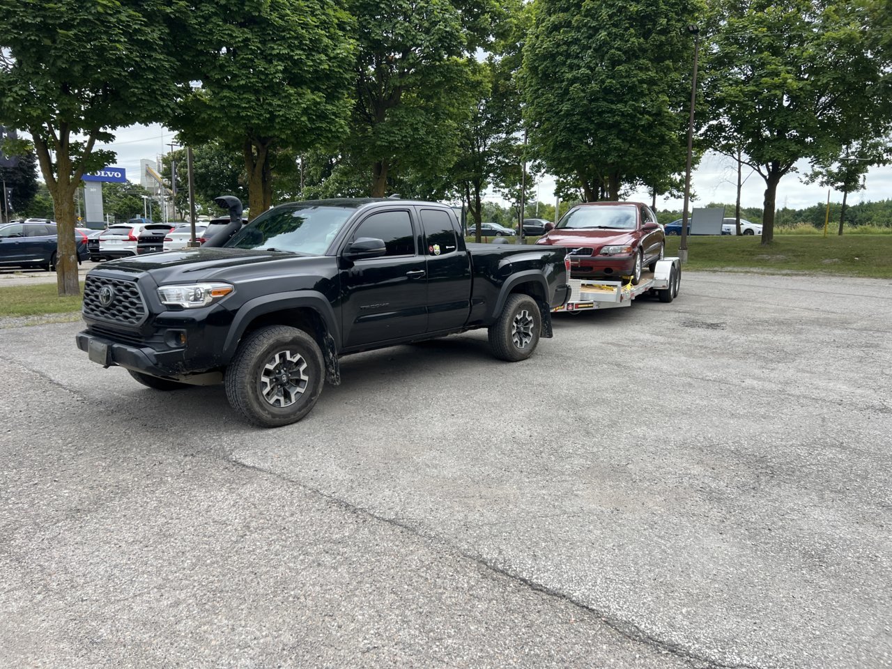

    Here’s my truck towing 6000 lbs. The weight isn’t so much the issue, it’s more the wind resistance. This setup, was literally no problem. Got 14mpg, towed like a dream. Wasn’t winning any races, but it was stable and stopped fine. My 2800 lbs travel trailer is harder to pull because it’s a brick fuckin wall going thru the air.
    My point is you’re gonna be just fine lol.
    Edit: forgot to mention my truck has Firestone airbags with a onboard compressor for on the fly adjustment. I love them.
