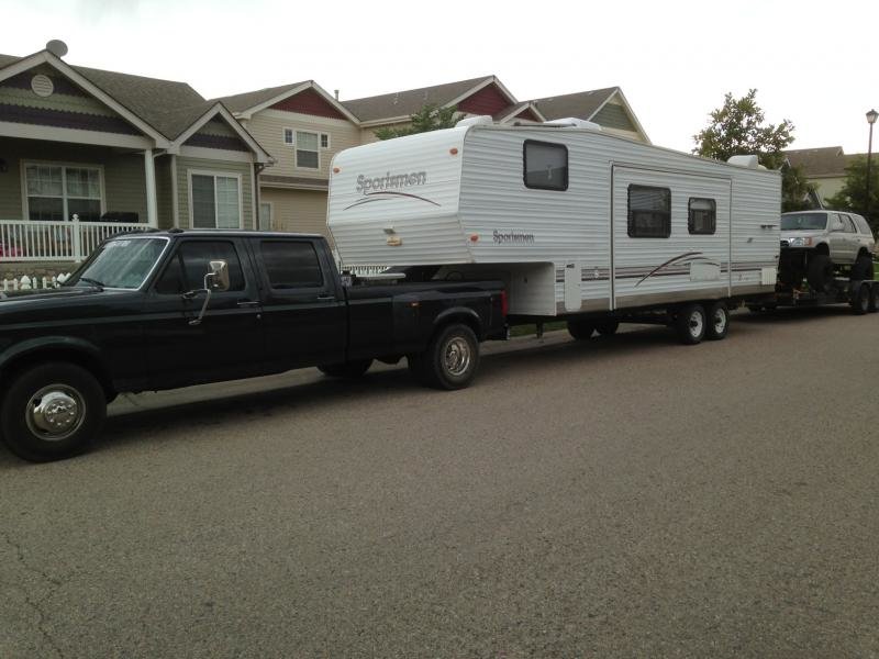

    2000 4runner. Linked and locked
    Grossing close to 26K
    1994.5 F-350 7.3L powerstroke. Stage 1 injectors, intercooler, valair clutch + more mods. Roughly 400hp & 800ft/lbs. Pulls it with ease honestly. This was a trip coming home from Buena Vista, CO over Hwy 285.
    1002874d1376928547-1994-ford-powerstroke_da0424850498e07af53cbaf13bfcebd239b6e521.jpg
    Even brought the kitchen sink.

    Is that thing even legal?

    Yup. Good to 70ft in Colorado. And, several bordering states. I'm right at 70ft with that setup. But, I will be around 5ft shorter with the buggy on my 14ft trailer. The one pictured is a 20ft deck.

    absolutely. ive seen plenty of people pull doubles. even triples (camper, flat trailer with atvs, and a boat)
    takes of course a ton of power and a very well cooled tranny!
    nice set up addicted! wheeling with comfort!

    Jesus fucking christ. That thing is insane.. arent the 7.3's supposed to be bulletproof right?
    Very nice setup, i've got a 82' pickup that i plan to tow with my taco, i dont doubt it'll have too many problems once i outfit the right parts(airbags,beefier leafs,brake controllers ect).

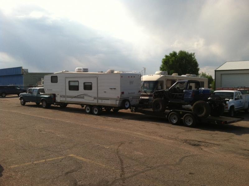

    This truck was extremely neglected when I got it. I'm married to it at this point. Just too much $$ dumped into it. But yes, its bulletproof. Its my 4th powerstroke that I have owned.
    96 F250
    97 F-350
    01' Excursion
    and this 94.5 dually.
    I will never own anything again for full service towing except a dually.
    Diesels are just extremely easy to get power out of. I've dropped a lot of $$$ into the 94.5, but its been worth it. I towed my truggy and my buddy's first gen 4runner to CA for a full 8 days of wheeling over the summer. Never needed to downshift once out of 5th gear the whole way there. Only had to for the last 1/3 of the Park City, UT pull on I-80 and that is only because some guy boxed me in. That was around 24K gross. We were full loaded with camping gear for a Rubicon/Dusy Ershim trip. Before the paint job too:
    978689d1375279690-1994-ford-powerstroke-_91677011940a999b62f99217ce44f917968527b2.jpg
    I love the old body style Fords. IMO, is the toughest truck you can buy. It just takes some $$$ to get them up to par power wise with the newer diesels. Still way less $$ than a new truck though. I love Cummins motors, but the truck wrapped around them is a complete pile of crap.

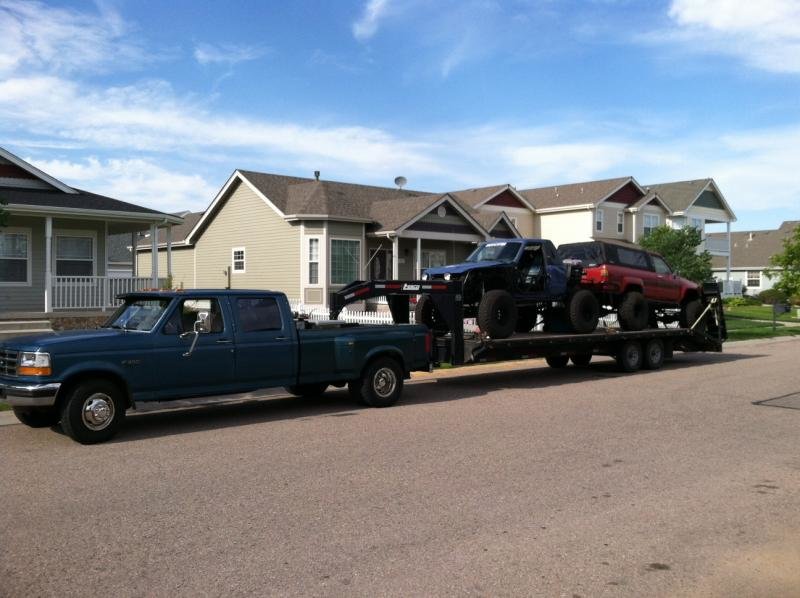

    Here is my Ford all cleaned up:
    1004625d1377044907-1994-ford-powerstroke_fadf511c705d79fef5df65123115cc8ebe594f90.jpg

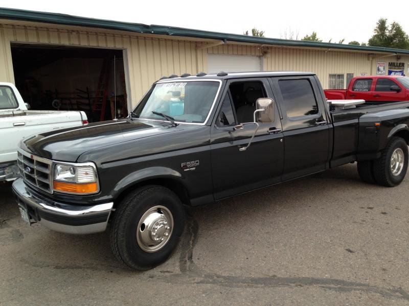

    And with my truggy heading to the mountains:
    952801d1373303402-1994-ford-powerstroke-_728d31c024f6f7f50b5911a943cf26820a63f24e.jpg

    My best friend(red 1st gen 4runner above) pulls with a similar setup. He is about 5K lower on combined weight though. I can still pull away from him on long pulls though. :D
    His truck is a work in progress as we build it up. He's always blown away when he gets in mine and pulls away from guys towing 10K less than we do.

    Its hard to say. Power wise I could pull more. But, the axles, and brakes are pushing the limit as is.
    That 3rd gen 4runner in the first pic is one of my employee's rigs. Its a solid axled rig on 37s and its a 5500lb pig. That was likely close if not over 26K. Keeping it under 26k keeps me legal in the eyes of DOT. Anything over 26K will require a Class A license.
    My new double cab will likely tip the scales around 5000lbs when I am done. But, I don't plan to pull it around a lot behind the 5th wheel.
    Oh, and I average around 8.5mpg with the whole setup. With just the buggy or truggy I get around 12-13mpg. Best I have ever gotten unloaded was around 18mpg. I average around 15mpg in mixed use though.
