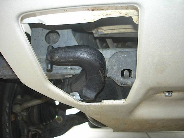

    I think he might be referring to the $100 OEM tow hook that comes standard w/ the OR package (front passenger side). Then you'll need the extended bolts to come with it.
    The problem with using a generic hook is the bolt positions are staggered, causing a generic hook to be cock eyed.

    Pster, is this what you are talking about?

    But these are interesting as well....I have the OEM skidpad. What are these used for? Towing?

    Gotcha. The hook pictured above is for vehicle recovery. They are really beefy and have a nice design to them, but $100 :eek:
    There is actually another hook that you cannot see in the picture. It is attached to the rear of the hook and is used as a tie down point when towing your truck on a trailer. Not that Tacomas get towed very often but hey, its there if you need it.

    It is a OEM part, and comes stock on the TRD Off Road trucks. Although, you can replace the chenchy little L bracket tie down point that comes on all other Tacoma's with this hook by using some longer bolts. Don't have the P/N off the top of my head, but saw it over at trdparts4u.com just last week. IIRC they were $90 +/- 5 bucks the extended bolts are about another $15-20 for a pair.
    The shackles work well, but the loop on the drivers side that is welded to the front brace is no where near as Strong. If you get to jerking on it too much I could see the welds breaking, and have heard of bad experiences over at TTORA. All in all, I'm sure a shackle through the tow loop will suffice in most all situations.
