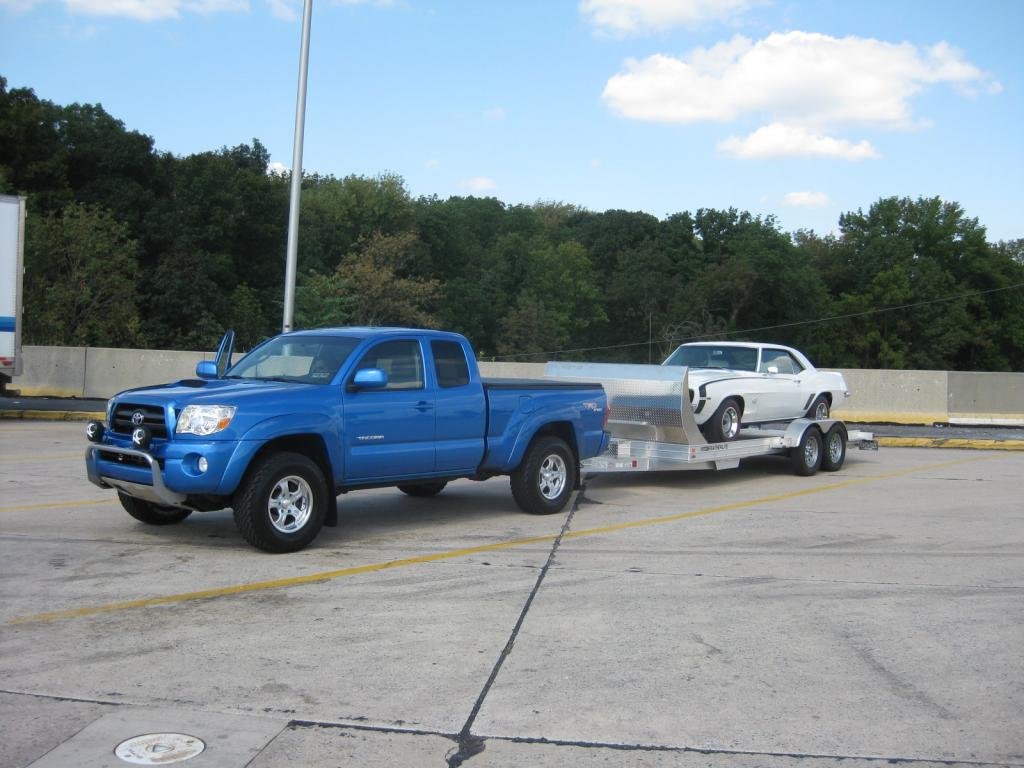

    1200 pound trailer.....3600 pound car..........200 pounds gear.....right around 5000 total. TRD intake and exhaust, automatic, 8 ply tires and air bags.
    The TACO tows like a champ on everything but steep mountain crossings.....and then you will need to keep your "foot into it"....
    I put around 8000 miles on the trailer and truck using this combination.
    I agree, keep it out of OD.
