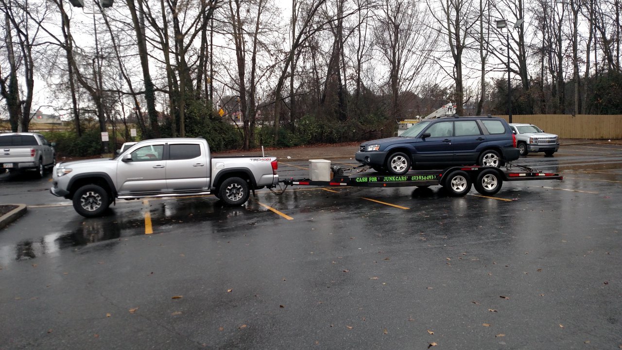

    I wondered how the 17 Tacoma TRD Off-Road would do Towing and a Heavy load. I went to Atlanta Georgia from Chattanooga Tennessee and picked up a Subaru Forester SUV and loaded it on my 20-foot car trailer. The combined weight was about 6800 pounds. I ran at 65 miles per hour and on level roads the RPMs were about 3000 on steeper about 4,300. I had installed the larger rear bump stops sold by E-Trailer which really seem to help with the weight. Others post that they have problems with Towing but I didn't have any

    What do you mean by bump stops? Sumos?
    What was your mpg?
    Looks like there may be a bit more squat than I'd be comfortable with. Is the car sitting forward of center on the trailer? Any guesses on tongue weight?

    Maybe add a leaf

    Combined weight of trailer and vehicle? Seems a bit high no? Trailer must weigh alot.... like 3000 lbs??

    Bump Stops-The Rear Rubber Stops that Mount on Top of the Rear Axle up to the Frame.
    MPG was right at 15.
    Your right there was a little more squat even though the SUV was centered on the trailer, I have now ordered a trailer equalizing hitch which will correct that problem.
    Not sure about the tongue weight but I would guess about 700 pounds.

    A trailer equalizing hitch will correct the squat in the rear.
    This is a 20-foot all steel double axle trailer with tool box loaded with tools that weighs about 3300 with no vehicle loaded on it.

    The trailer is between 3300 to 3500 lb depending on the amount of tools and chains that I carry

    Were the bump stops you added a dark blue foam?
    6800 seems high, a forester is under 4000.
    I think I towed (3500 lbs) once without an lb hitch, adding it made a lot of difference.

    The bump stops I ordered from e-trailer are the big black thick Ones rated and 6800 lb it's like adding another Leaf to your rear springs

    Thats what air bags are for. Even 2500’s need bags for towing its an easy fix. Cool review OP thanks for posting. I have no issues towing my 18’ fiberglass bass boat and plan on getting a large tent trailer soon

    Never was a fan of airbags because they seem to have a problem often and leaking down, I found the 6800 pound rear bump stops sold by etrailer work well with no worry about air lines.

    If you plan to tow, ditch the bump stops and get bags. They dont usually have issues with leak down if properly installed and cleaned every now and then. You can also add a self leveling setup and not have to worry about filling them up or airing them down.
