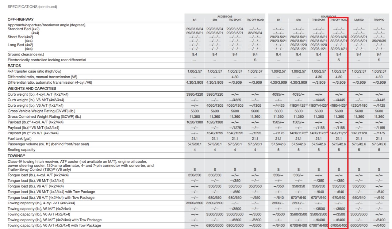

    Do note that the 6800lb capacity is only valid for the 2wd access cab configuration. 4WD DCSB TRD Off-Road is a little less at 6400 with 1175 for payload and 640 for tongue weight.

    Nice chart PJnc284. I guess I figured the Off-Road would be maybe 100lbs heavier than the Sport but apparently not.

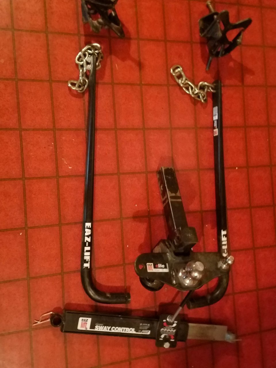

    20180121_153520.jpg i am looking at a towing stablizer system. I was told that as long as my trailer and taco are level before loading i cantow my jeep CJ7. Not worried about the gas mileage i am worried about the crappy rods in Arkansas back to Texas.

    They are different stabilizer systems so do your homework and don't cut corners on price. Just make sure the Jeep and the trailer are 6800 lb or less and you shouldn't have any problems.
