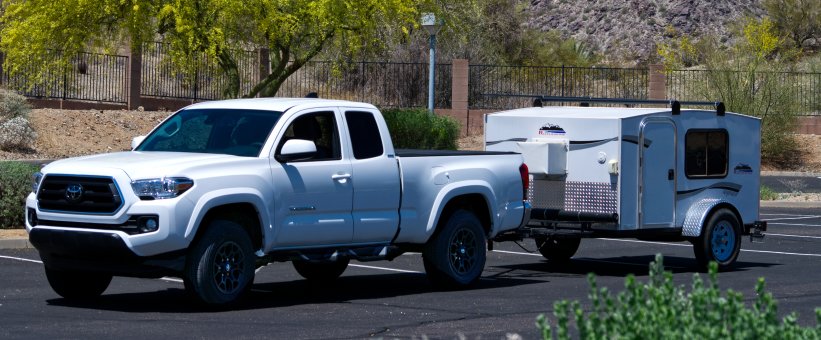

    I take a big MPG hit towing a 1,000 teardrop - of course it's not exactly aerodynamic either.

    A lot more aero, then a 24ft travel trailer. I take a hit, with a 6x14 v- nose enclosed. Dry weight of 1400lb, loaded 3500lb. Not a true joy to pull. Miss 3/4 and 1 ton trucks I previously pulled that trailer with.
