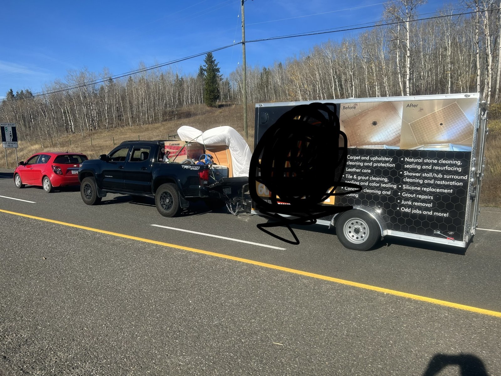

    Some Serious Tires
    Yep. Would not wanna tow this often:IMG_1332.jpg
    I miscalculated and definitely overloaded my trailer by at least 1000#….
    :facepalm:
    Was an interesting 10.5 hour drive…
    Lt. Dangle and TnShooter[QUOTED] like this.
