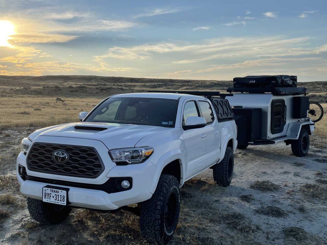

    I have a 3500# (Gross) Vorsheer XOC and an RTT on my Taco with a Decked drawer setup. OME-005 Heavy suspension on 275 70 17 KO2s. You'll be fine towing at that weight, just remember the TRD Sport comes wired for a brake controller so installing one is on you. I went with a Redarc Tow Pro Elite and it has performed well this past year that I have been full time living on the road.

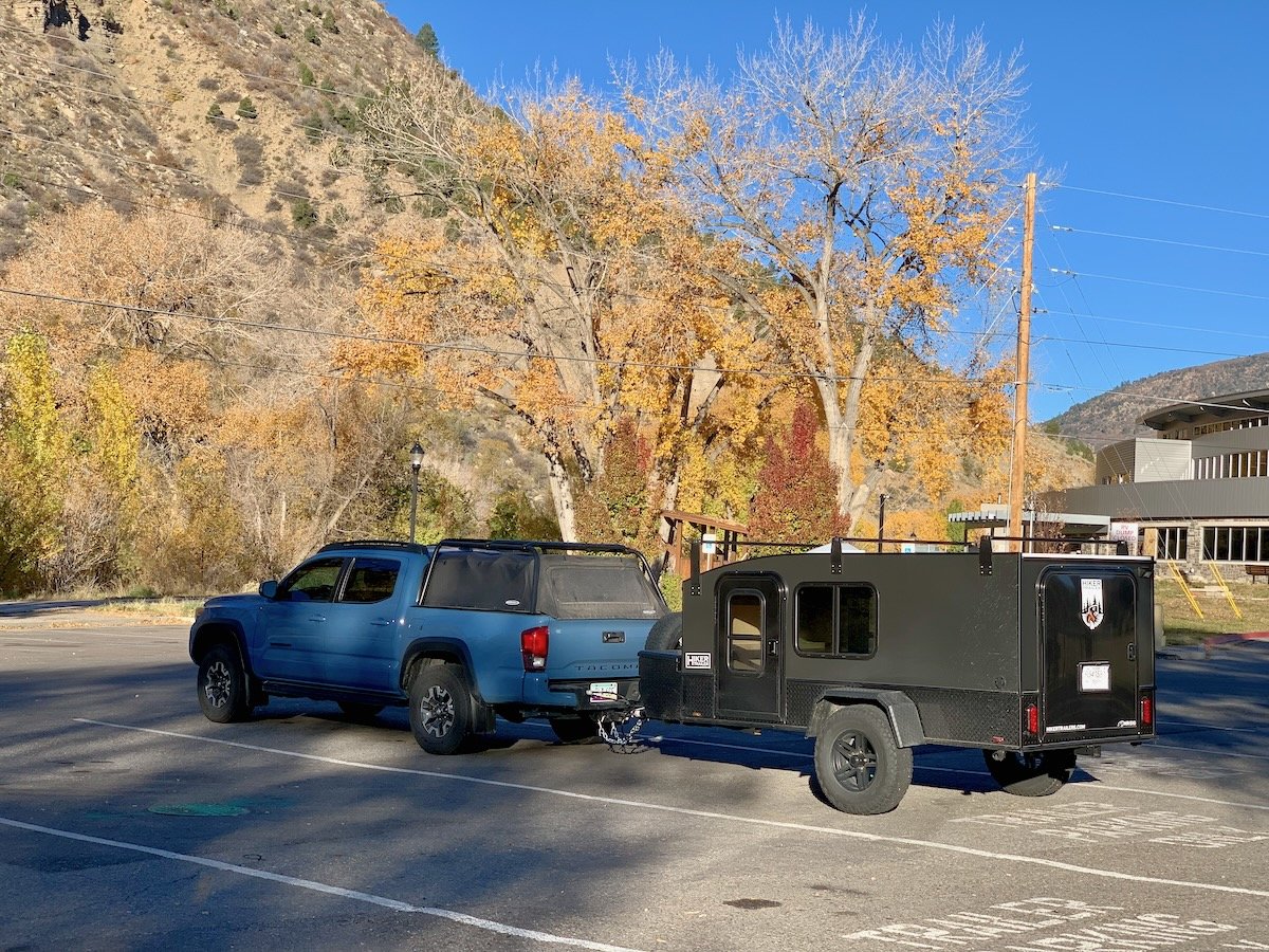

    My wife and I pulled a 5x10 Hiker for 2000 miles (Indiana to Phx via ColoRADo) two weeks ago. Flat, 65 mph and no wind, 18-19 mpg. Add cross wind, drop to 14 mpg in a hurry. We had 370 lbs of gear (weighed all when we were home on a bathroom scale as we carried stuff in) and the empty Hiker with a 115 lbs tongue. I added blue Sumo Springs before the trip, glad to have them once I was pulling (they made contact when the trailer was hitched). I didn't feel any need to do more than 65 mph, but @Rock Lobster and I have a similar mindset to travel. I didn't do trailer brakes and controller, but after this trip I will be adding - had a somewhat fast required stop going through Lincoln NE.

    This is a nice setup!
