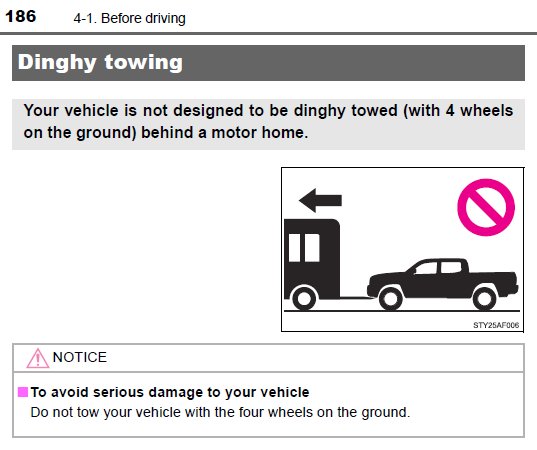

    Now, I'm not saying that I'm an expert, but it does say this in the manual:
    Anyone know why?

    That's why op is going to make a driveline disconnect

    Ok yes the driveline disconnect will enable the towing 4 down. Thanks for the manual pic post though. I hope someone has a idea about the steering keeping the steering wheel unlocked. I might have to dig into the colum deep and dismantle the steering wheel lock completely if there is no other way. I really really really do not want to do that. But I am going to tow this thing 4 down! Thanks everyone for your thoughts so far!

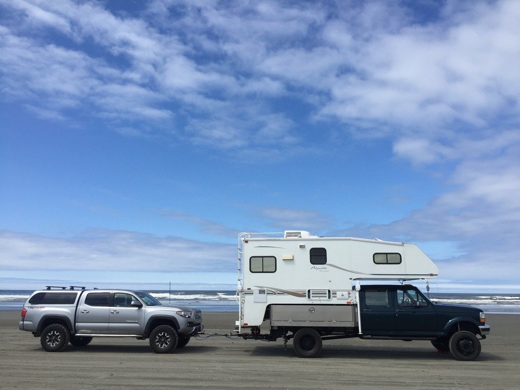

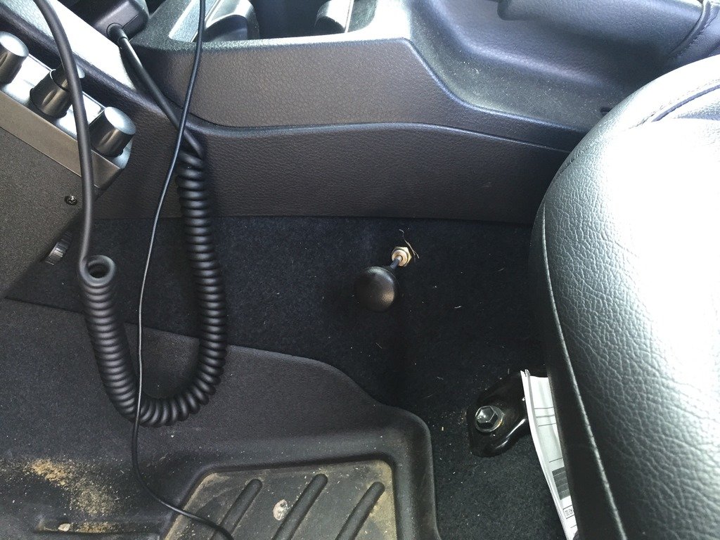

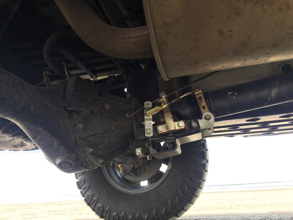

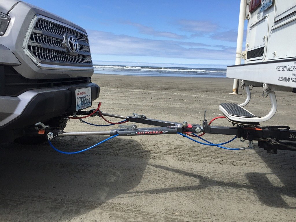

    Done! Love it! 4k logged no problems! I may hit something and rip the shifter piece off the diff. If I do I can crawl under and slide the disconnect by hand. Disconnecting it with the pull lever inside the cab is more convenient. We will see!
    I ordered it from the place below and my local mechanic installed it.
    http://www.swdriveline.com
