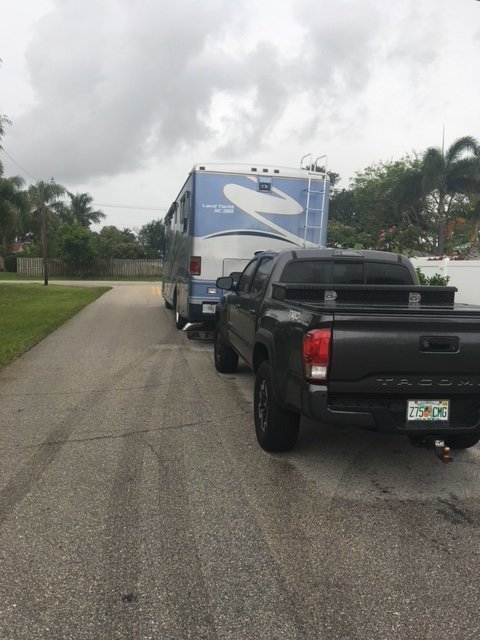

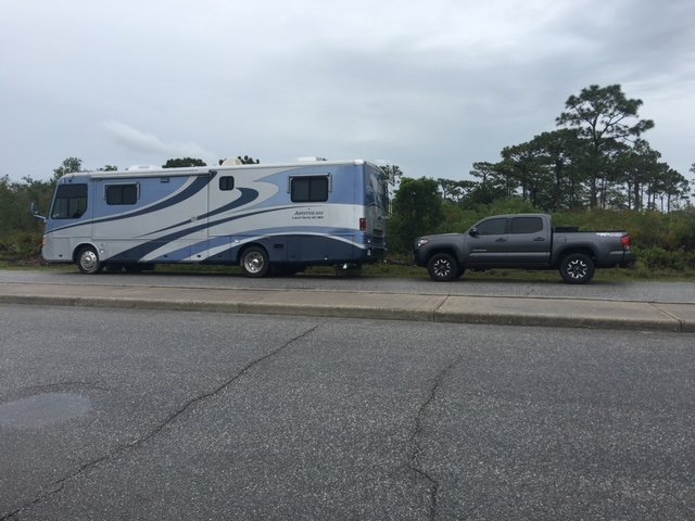

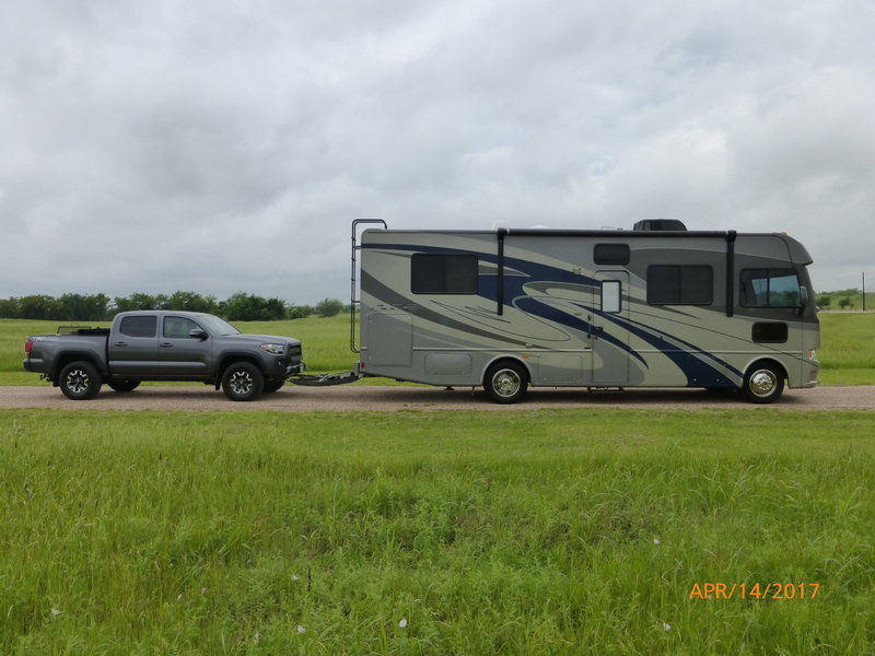

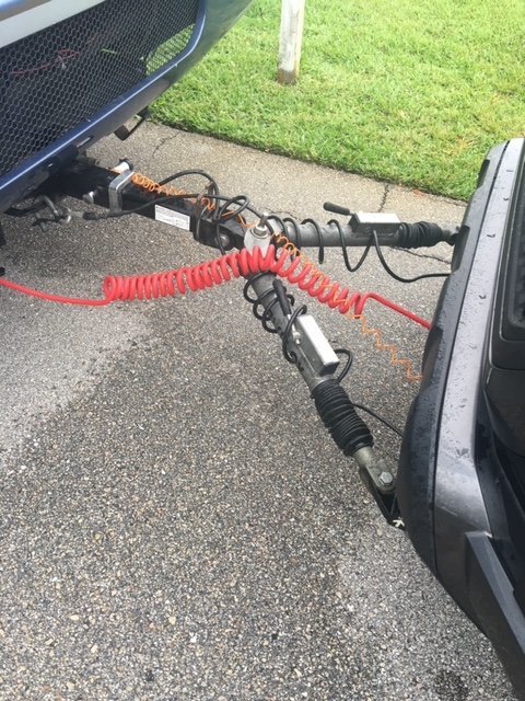

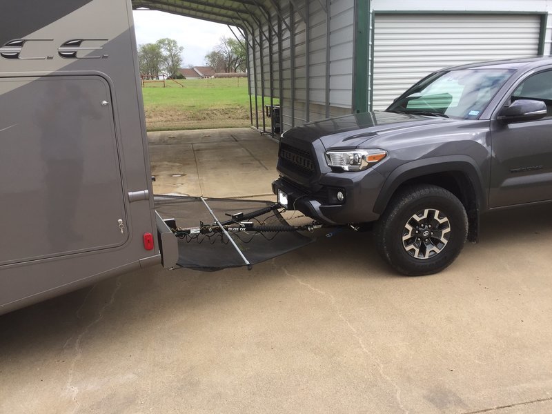

    I know this is an old thread, but I want to thank everyone that contributed to it. With this help, I was able to get my 3rd gen with the push button start set up as my towed. I went with the battery disconnect and didn't even attempt the column disassembly method. Thanks!
