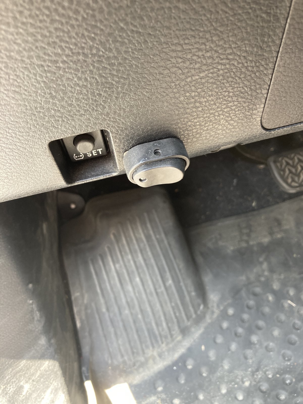

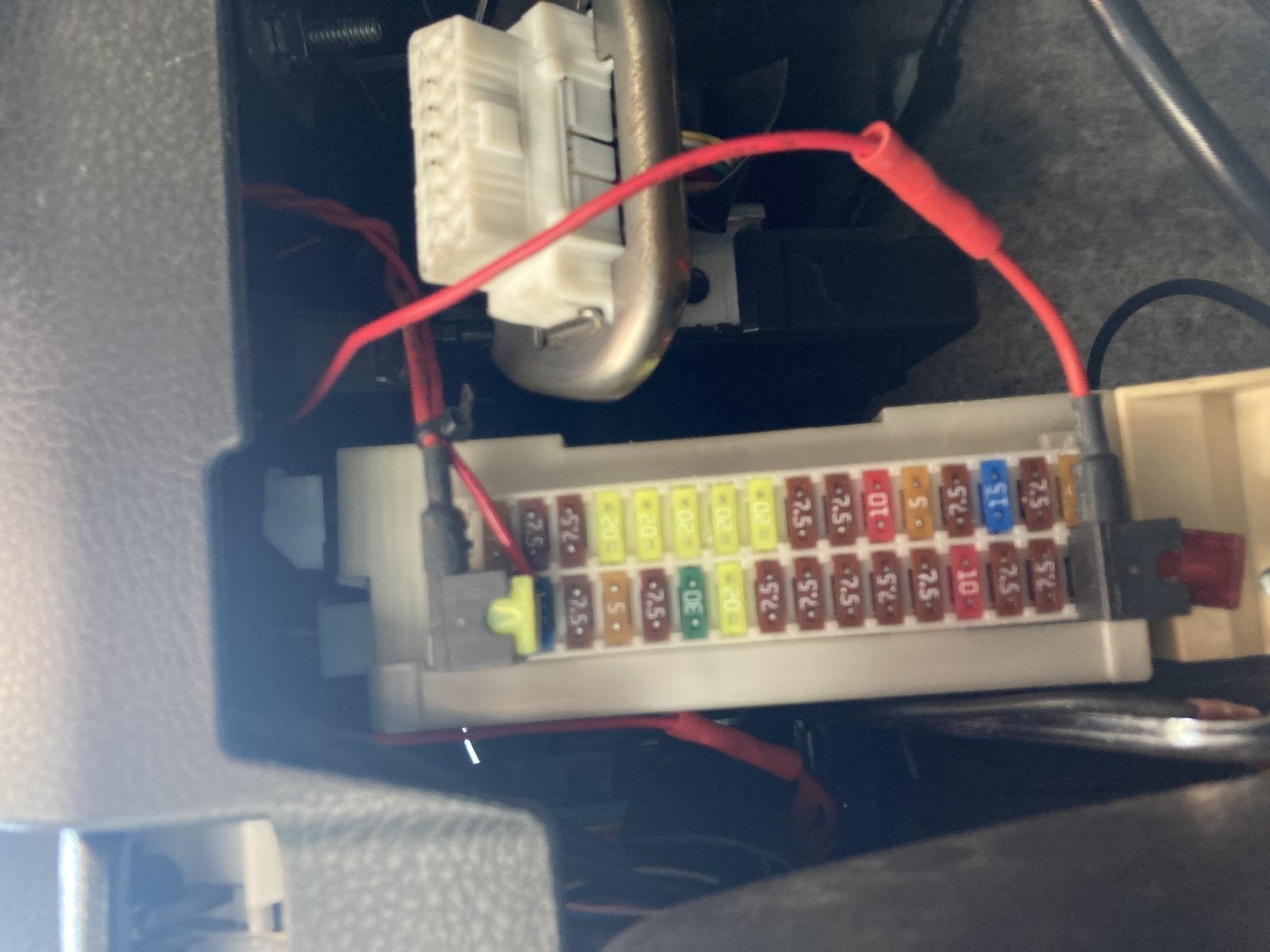

    Ken
    2019 TRD 4x4 Sport
    ARE Z topper, Roadmaster baseplate, Remco DS disconnect
    On page 2 is the post by yellowstone22 that describes how to do it. An yes, there is a specific fuse he identifies. Sorry but I don’t have any pics.
  17. May 10, 2024 at 2:52 PM
    #57
    pdeinc
    pdeinc Well-Known Member
    Sep 17, 2021
    #377365
    171
    Ken
    2019 TRD 4x4 Sport
    IMG_9103.jpg IMG_9105.jpg Here are pics of my steering lock bypass switch.
    riz_atx and OnHartung'sRoad like this.

    riz_atx
    riz_atx #bigpermtaco #teamBP
    Jan 5, 2017
    #206621
    10,674
    Sohail
    Spicewood Texas
    ‘16 4x4 DCLB GFC Locked, Geared, Tuned
    C4Fab/RCI/BAMF, ADS, 4.88, Lockers, OVTune
    Can you describe how this is setup? I want to recreate it.
    Would I use a fuse tap on the steering lock fuse and then put the OEM fuse on the bottom of the tap. Then wire in a switch to the top fuse spot of the tap? This is where I am a little confused. Any help is appreciated
