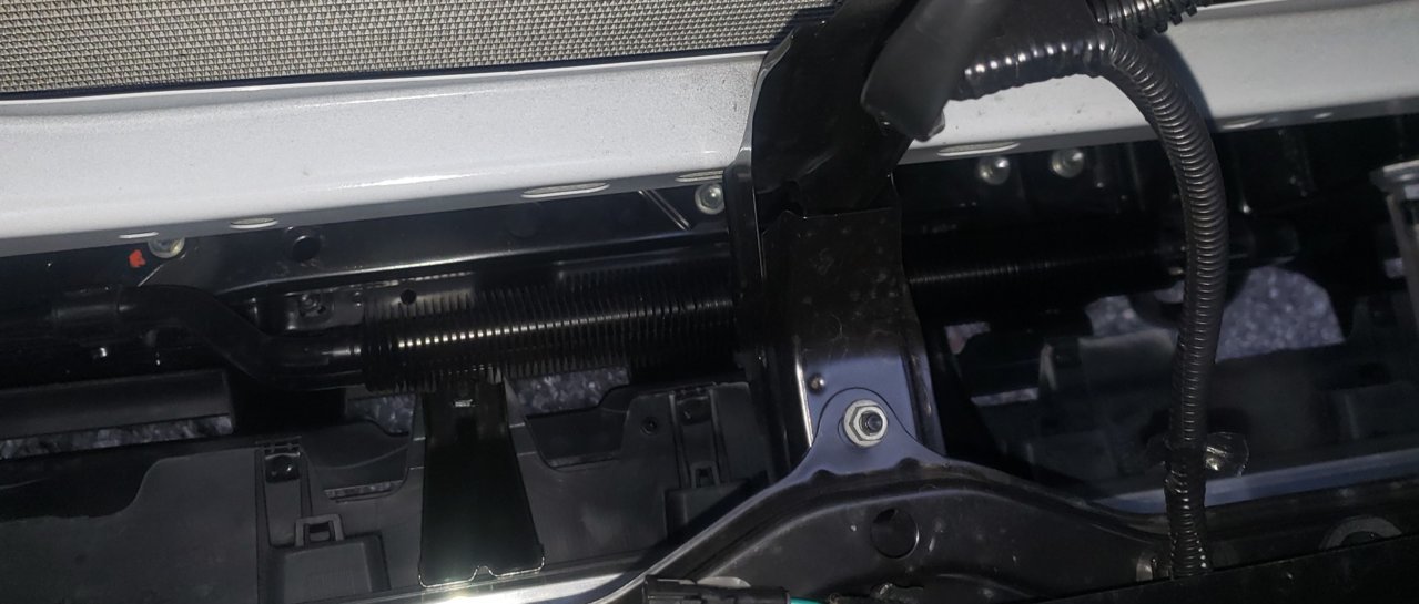

    Sorry hard to see but this is on the front of the radiator, all the way at the bottom

    That's the PS cooler.

    Would the trans cooler have been close by if I had (have) one ?

    Sorta. Like I said, it is attached to the left side of the main rad. See @TnShooter 's pic here:
