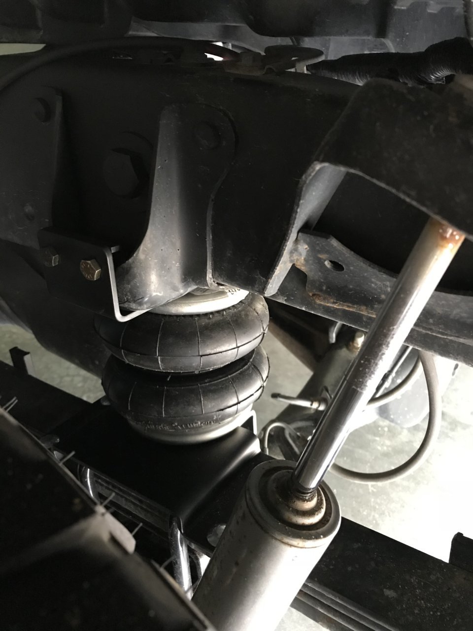

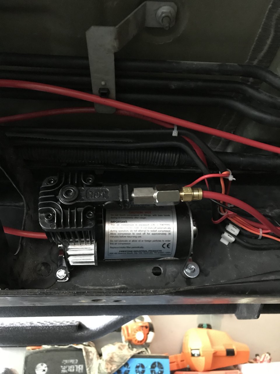

  9. Aug 15, 2018 at 12:06 AM
    buckhuntin-tacoma
    buckhuntin-tacoma Shed hunter
    Dec 10, 2017
    #238191
    14,608
    Dennis
    Quincy IL
    2014 Spruce Mica Tacoma DCLB
    Firestone Ride Rite air bags and compressor from SDTRUCK Springs $560CBE16286-D224-4ADE-8888-BC9982AE02F8.jpg4344240A-170E-4508-BA62-5F40344D5E2B.jpg
