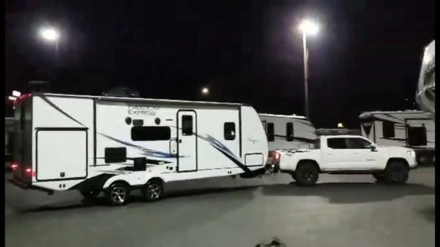

    Which model is that? I'm guessing that's a outdoor kitchen on that back door...

    Freedom express 248rbs. Back door is an external frig and sink. Just got it tuned by K&D with 87. Makes the trailer feel lighter.

    Thanks, that is a beast! Where do you live? what sort of terrain are you driving in?
    What do you mean by tuned by K&D with 87? TIA!

    Paved roads for sure when on the move. Never tried off road or beaten paths. Your welcome to read my forum about it.
    The K&D tune I am referring to is this.
    I do back it in on in incline over dirt and grass. Trailer dolly wouldnt budge it. (Trailer velet xl). Planning to return it and get the parkit360 for brake control and motorized.

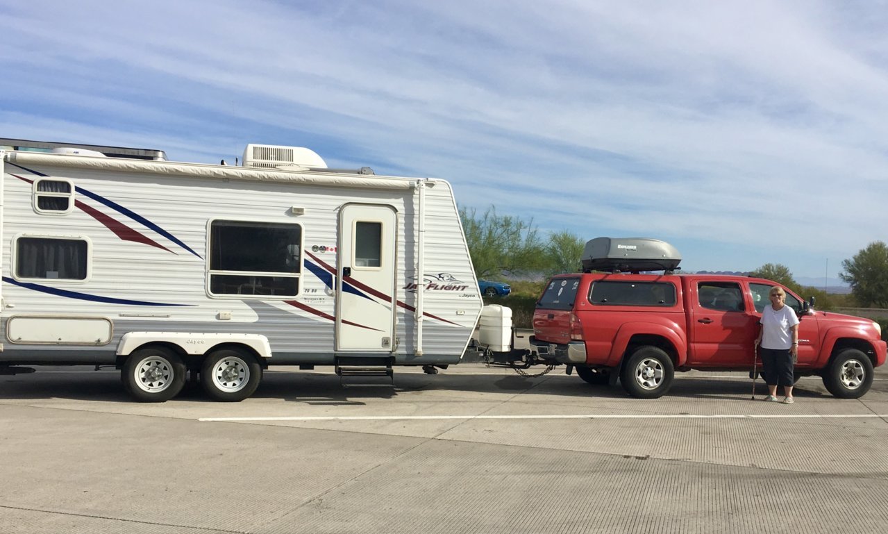

    I have a 2006 Tacoma 4X2 SR5 4.0 235hp 5speed overdrive auto tow package air bag built in Fremont California. Towing capacity 6,500 lbs. I tow a 2006 20' Jayco Jay Flight and have towed all 32 states of Mexico, Canada and USA. With over 400,000km it still tows real good. Tow in 4th gear and will drop to 3rd gear climbing long hills and keeping revs at 3000rpmIMG_4682.jpgIMG_4682.jpg

    I really like your setup. It is pretty cool to see someone really putting some miles on.
