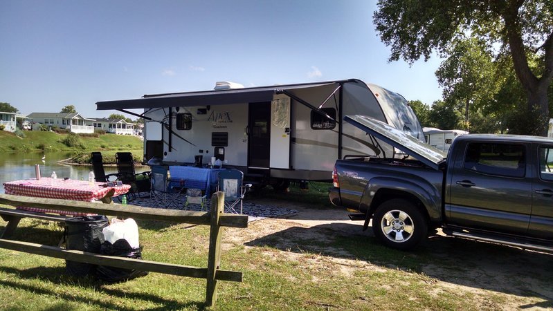

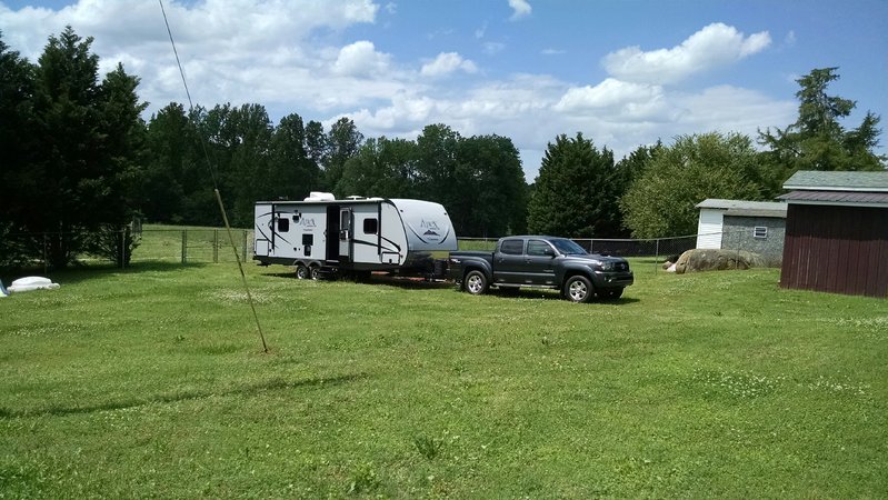

  7. Jun 13, 2016 at 4:21 AM
    Tarus 9mm
    Tarus 9mm Blessed
    Aug 30, 2015
    #163035
    39
    2011 dc prerunner Tacoma TRD Sport
    East coast towing experience here & I have no problems 10,780# rolling down the road. Yea I know I'm at the max on tow,payload,hitch but these trucks do great! Enough stated here in the Carolina's "Coachmen Apex 250RLS "
    Tacoma’20 and Iamraiderpower like this.
