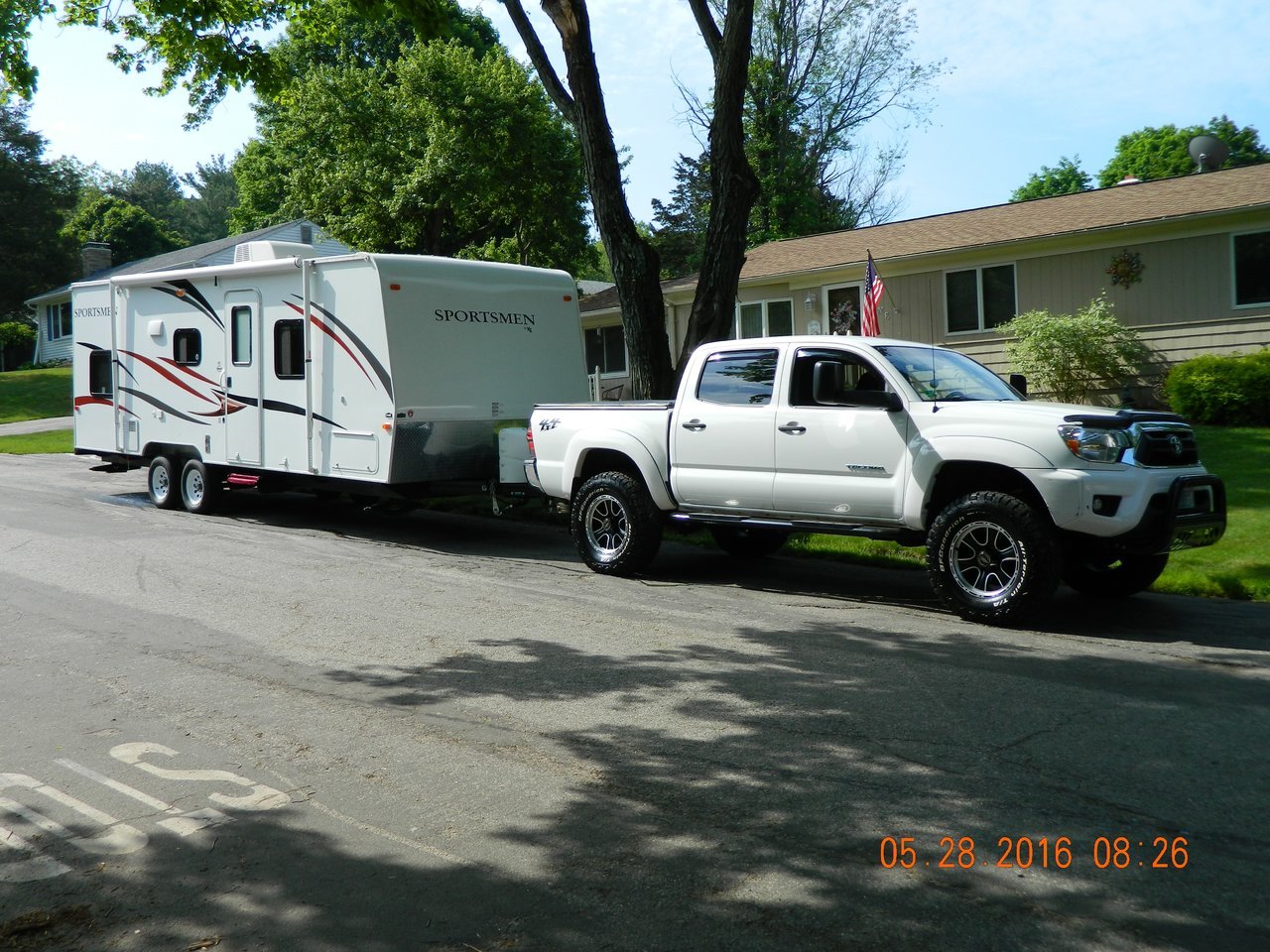

  19. Sep 21, 2017 at 11:26 AM
    #19
    gmann1972
    gmann1972 Well-Known Member
    Aug 24, 2015
    #162600
    686
    Greg
    Rhode Island
    2013 tacoma SR5 DCSB
    I'm towing 5500lb - 6000lb, depending on how long I am camping for. I have no problem towing my KZ Sportsman 242BSHS. Just be sure your truck is equipped properly to tow your camper safely.
    rkilgore76, Tarus 9mm, tcBob and 2 others like this.
