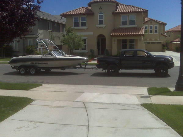

    2008 4x4 Tacoma Sport
    Mods so far: Tube steps from toyota, Bed extender from toyota, Spare Tire lock, Sound System Makeover, Tacoma All-Weather heavy duty rubber floor mats. Rear TSB, Icon Coilovers w/ TC UCA's and 3inch rear block with rear 5100 bilstein shocks, Black Headlights, Grillcraft black grill, Devil Horns from Andres, Black Headlights, Chrome Liquid Metal Gatlins Wheels, 285/70R17 Nitto Tera Grapplers, Wet Okole Seat Covers! Seat Belt Chime Mod, Flowmaster 50 series dual exhaust, Debadged tailgate, TRD Decals, HID hi/low + fogs.
    Nose in the Air
