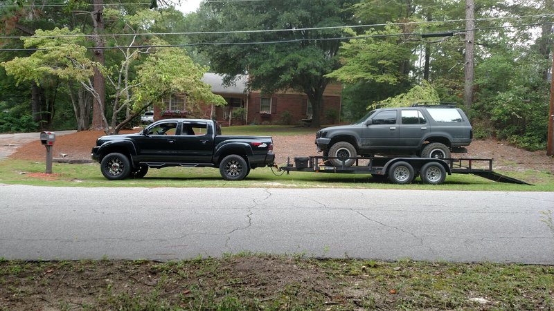

    Yes truck will tow more than it is rated to but trailer brakes are a must this 4runner and trailer was about 6400lbs

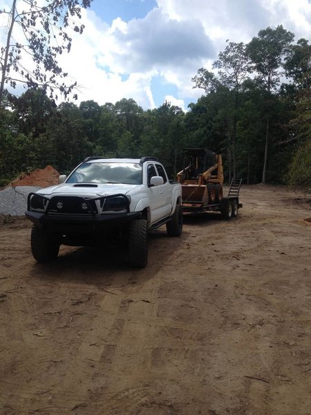

    CASE 1840 Uni loader and a 16' tandem axle trailer. Trailer brakes are a must.

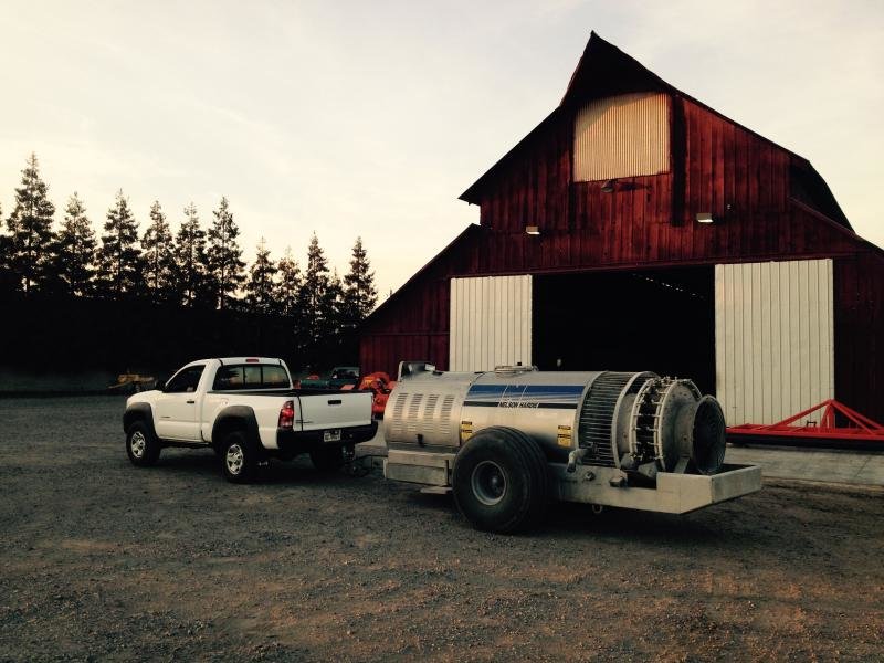

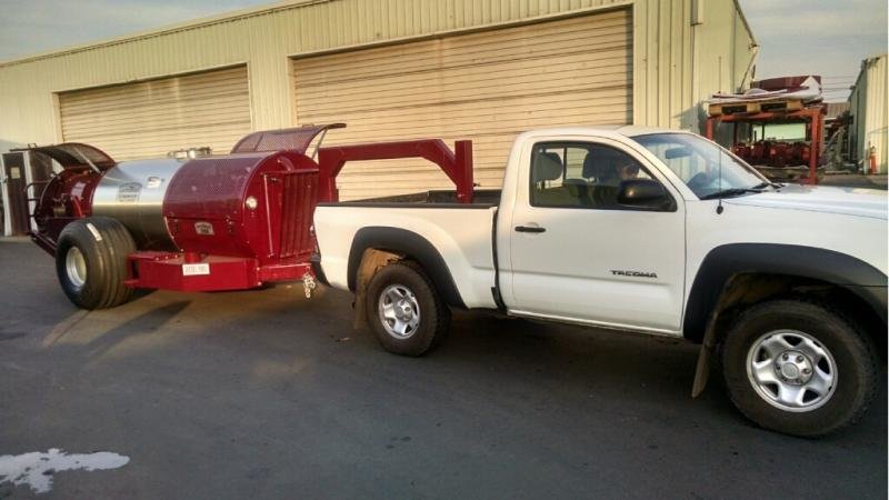

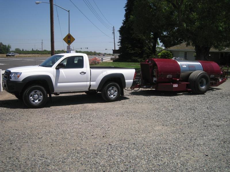

    FYI when these orchard spray rigs are EMPTY, they weight just under 6,000 lb. When their 500 gallon stainless steel tanks are FULL, well, you do the math...~ 8 lb. per gallon = 4,000 lb. Yes, most of this weight is centered over the spray rig "axle," and yes, when they are loaded FULL, they travel 2-5 mph through the field maximum speed, but they are still tough beasts.

    Custom-built hitch (plate and channel steel) that uses the factory bed bolts for an attachment point, along with block spacers on the frame.

    I would like to know what each of those devices is. These look like fun with the Jet engine look in the second picture and all of them have high flotation tires... Interesting.
    *edit* thanks for the quick answer as to what they are.

    Here's the company website that builds the machines that we sell...they are impressive to see run!
