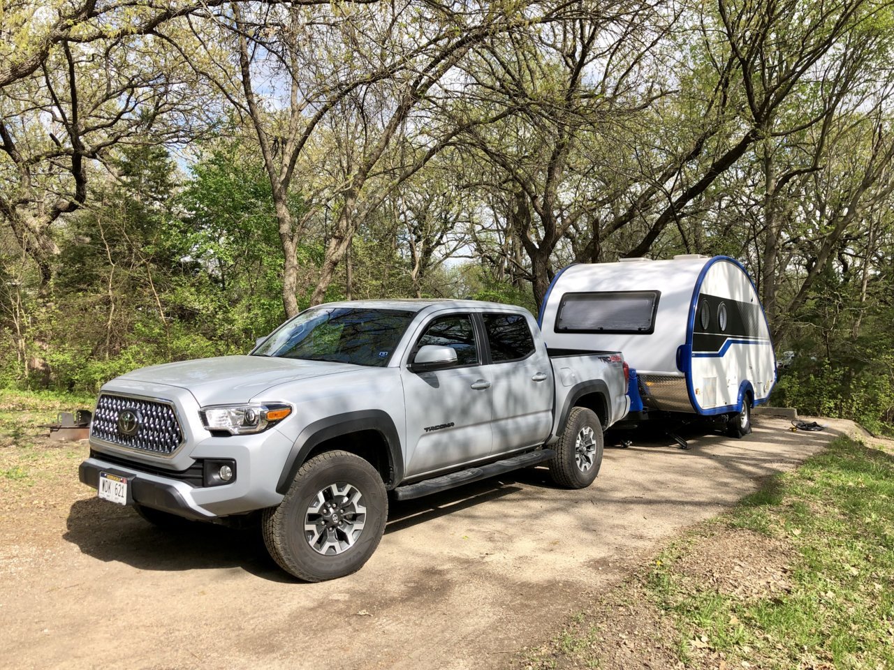

    I pulled a Tab 400 all over the Midwest this summer. Dry weight is 2800 lbs. I had no issues with MT towing mostly in 5th at 65-70 mph. Occasionally going up hills I would have to downshift to 4th. RPM’s were never very high—around 2500 when cruising. MPG was about 12 mpg. Mine is a pretty aerodynamic rig, but high winds do affect towing quite a bit.
    No offense to anyone, and I realize the AT is a different story altogether, but I think people who complain so much about towing with the Taco don’t really know how drive it, because it takes a little effort.
    I agree it does wear one out a little. It requires more attention than typical cruising on a 4-lane. The worst is having to pass up a hill for instance.
    I would have no problem towing up to 4000 lbs, but any more than that I’d go fullsize (our previous truck was a Chevy Avalanche 5.7L).
