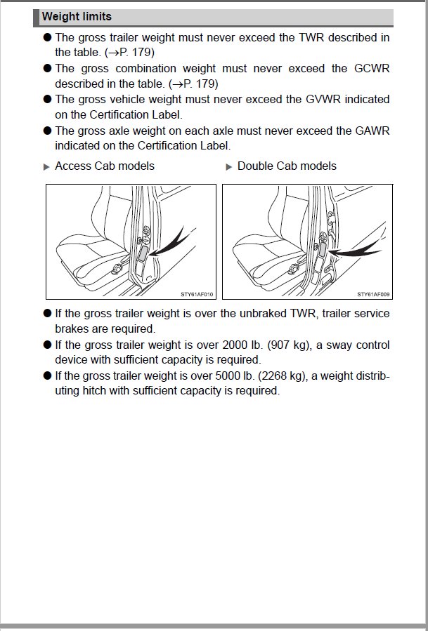

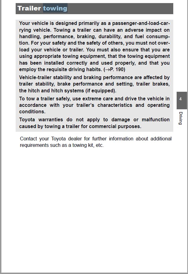

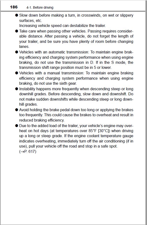

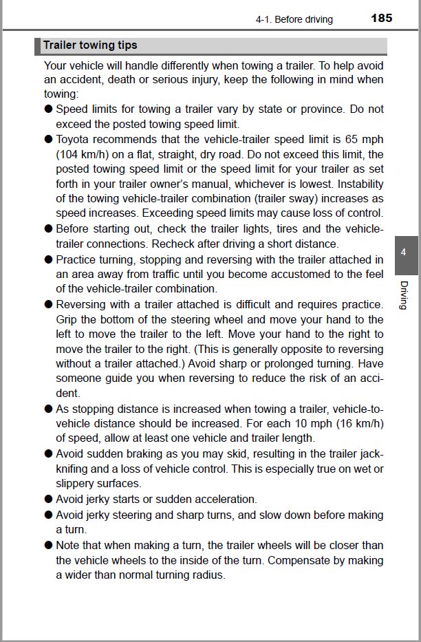

    That is not at all what I said. Here, let me help you:
