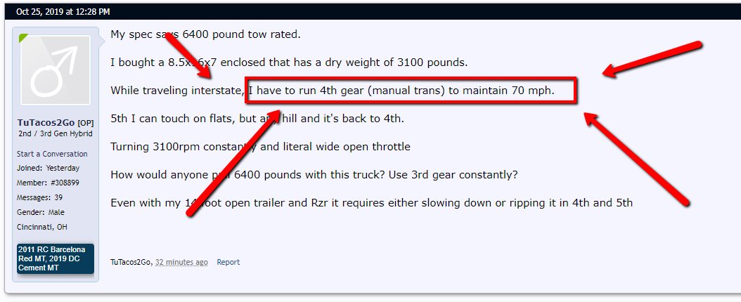

    I'd expect a factor of safety built in (margin)
    So yes, I sure would.
    I would also know that someone somewhere smarter than me tested the assembly and rated it.

    The simple answer to fix your expectation is first regearing 4.88 or 5.29, then consider OVtune. It really is that simple. What you report is just how the truck is, occasional load here and there. No magic.

    As to the book posting, I stand 100% corrected.
    I have indeed expected the truck to tow above 65mph.
    And yes I do know that everything changes at max weight.
    Reread the thread.
    I am towing less than half the max weight, but it dramatically influences the truck. I still say that's not 100 percent the way it should be

    There's nothing much to do about changing how the truck feels while towing except deeper gears. Other than that you have to live with it or buy a different truck.

    It sounds like "acceptable performance" to you is a subjective higher standard. Toyota has given the truck a tow rating per SAE J2807 standards. There are no promises of how it will feel, MPG when towing, acceleration, etc... but whether it passes the test.

    I think that we were all confused as to what you were expecting... When towing anything, you have to expect added resistance. It seems as if you were expecting the truck to drive with minimal added resistance towing a trailer; a very non-aerodynamic trailer at that. So yes, the truck will most definitely have to work harder... The issue was that your expectations were set way too high. That's on you, not the truck.
