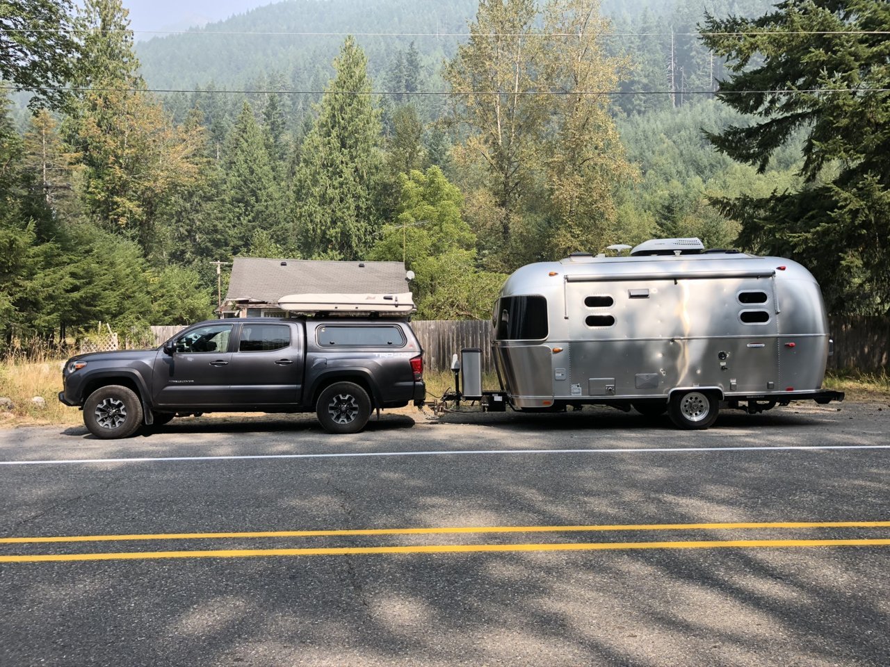

    All - just wanted to post an update. I took the new setup out this past week and had great success. I'm on stock wheels/tires/suspension. Trailer weighs approx 4200lbs loaded up and the truck did great. I have a blue ox 750 weight distribution hitch which helped a ton and a s2 brake controller.
    I was worried, but in truth the truck pulled just fine. In some cases on a big mountain pass (Snoqualmie pass in washington on i90) i had to get to the right lane and get up around 3500k-4000k in 3rd gear to keep her humming at 50-55mph going up hill, but aside from a huge uphill, things felt really good. I ran 89octane chevron fuel and was pleased to see 12.5 MPG (I fueled up at about 16 gallons down)
    Overall, just wanted to put something up to document the trip in case others are considering this kind of set up. Also, for what it's worth, I have about 300 lbs between the leer canopy and james baroud RTT, in addition to all our gear from having climbed Rainier (That's what the trip was for - but afterwards we did a bit of exploring on the east side of the state trying to beat some of this damned smoke!)

    Looks like it’s still squatting too much even with the WDH.
  5. Sep 14, 2020 at 5:40 PM
    Denimike24
    Denimike24 [OP] Member
    Aug 31, 2017
    #228677
    16
    2017 TRD 6sp Manual
    Any thoughts on how best to adjust? I'm using 9 links on the blue ox hitch, they told me with more weight to step up to 10 - perhaps that's what I should do. Also contemplating airbags or modifying my suspension. It was a super smooth ride, so I dont want to mess with much, but I do see that its a little off level.

    FWIW airbags or helper springs should only be added after the WDH is dialed in correctly. They are a "cosmetic" fix but the WDH needs to properly weight your front axle which it doesn't look like its doing right now.

    Thanks, Spencer... I suppose the hard part is fully understanding how best to do that. I bought the WDH from the airstream dealership, all they told me was "If you add more weight, you might need to go up to 10 chain links..." as opposed to the 9 I am using now. Do you think I should strap it down to the 10 chain links per that advice, or is this something I need to be getting on a scale, or running some calculations?
    My priority is that I remain smart and safe here, but I did get the blue ox 750, and my trailer tongue weight is supposed to be 550, so I should have plenty of room to adjust in theory, but alas, I'm a novice with towing so I'm still learning. I assumed the springs or airbags would make the necessary change so I appreciate you chiming in.

    I tow a 16' Bambi so I appreciate where you're coming from. In my experience, Airstream is all over the place with their tongue weights. I've had a brutal time trying to get an accurate weight on my trailer.
    My advice would be visit your local CAT scale with your current set up. They charge only $12 to weigh your rig. Then you'll know with full confidence how you're currently weighting your axles. If the scale says you're equal, the sag is cosmetic and you can add a product to fix it. If you're light in the front compared to rear.....you've got some work to do with your WDH. Hope this helps.
