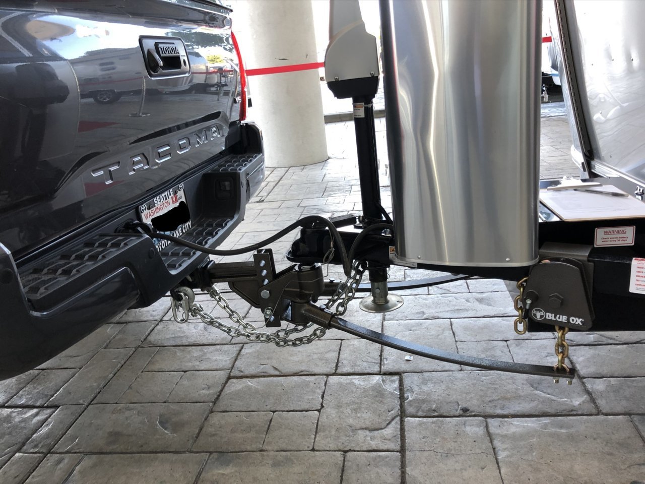

    Could you post a couple closer pics of the hitch set-up?
