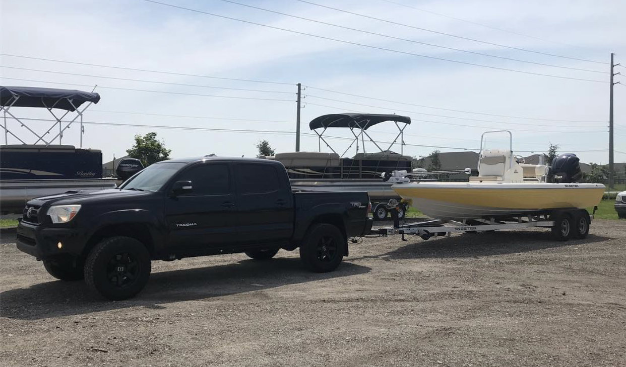

    Did you ever get one? My boat is close to the specs you asked about and my truck does fine. Trailer brakes on both trailer axles and I averaged 12mpg on my trip back home with it. F5CC1AAA-D14E-4716-A53C-CF7E6E42B839.jpg
