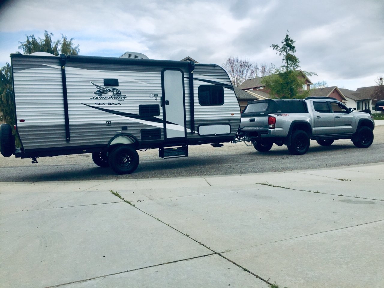

    I have the same truck and tow this (19ft Jayco) with sway control and airbags at 4,000lbs full not including what I put in the bed. I am re-geared, OVtuned with some armor and winch, adjustable suspension with heavy coils, and an upgraded leaf pack. It drives awesome with this setup.
    4500 lbs may be ok in a stock config on the highway (still going to suck), but hills and getting to camp sites will not be something you look forward to.
    Also, side note:
    You don’t “need” airbags with weight distribution hitches (some, like mine also have sway control), but it helps a ton in carrying weight and keeping the bounce out if there is any. Plus if with cradles they offroad just fine due to the bags not being fastened all the time
    I wouldn’t do it if I were you. Too dangerous without proper equipment/upgrades

    Hey man, hows that thing pull with the axles flipped. Did it come like that or did you do it after? Thinking of flipping mine, I've drug the plumbing boondocking a few times
  16. Jun 2, 2020 at 7:22 PM
    #16
    SpeySquatch
    SpeySquatch Function over Form
    Mar 6, 2018
    #246516
    7,366
    2016 TRD OR DCSB
    C4Fab LoPro, BAMF Sliders, Ext ADS 2.5’s, 4.88's, OVTune (OG to KDMax)
    It drives great, but it’s the Baja offroad package so it came that way. It has nice Goodyear tires too.
