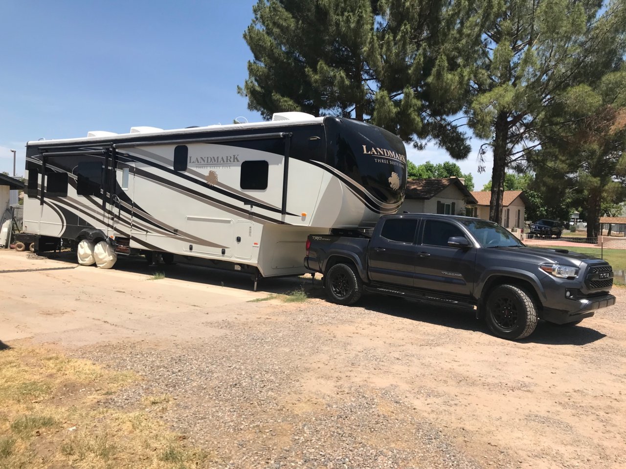

    I'm guessing the Tacoma was pulled under the 5th wheel just for a photo op since that trailer is at least 14,500 lbs dry.
    ..or where they just moving it around the parking lot?

    It belongs to a friend. We were just screwing around for a photo op to taunt Tacomaworld :duel:
