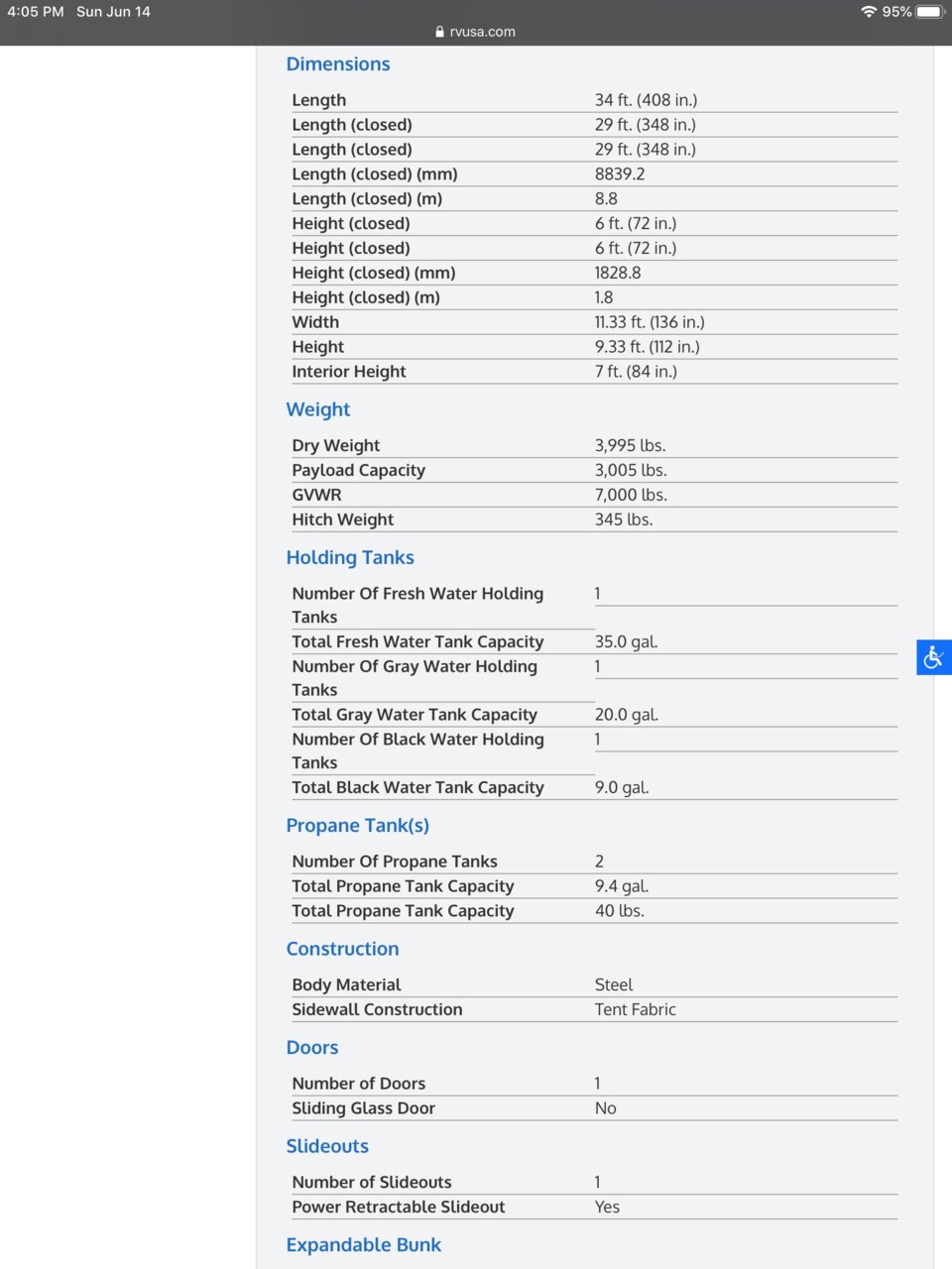

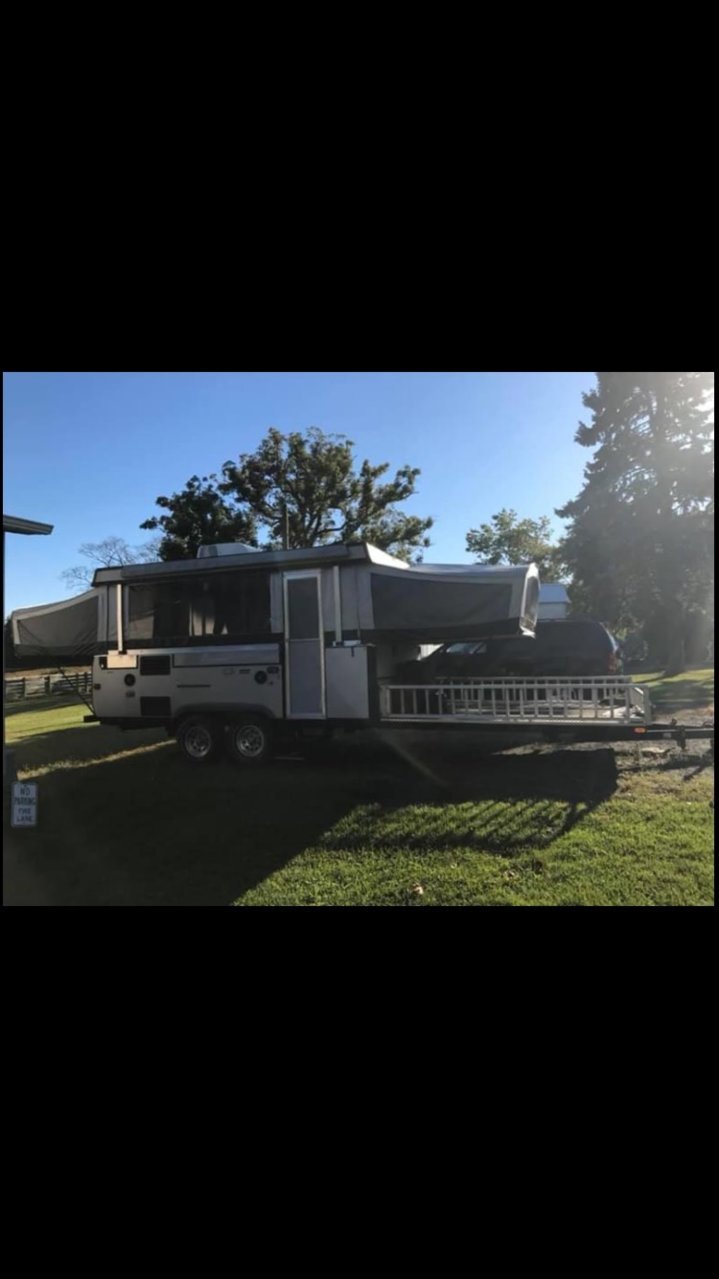

    Looking at this high side, tandem wheel Pop-up camper/toy hauler. Has a WDH and trailer brakes. It is long at 29’. Bike is 232 lbs, all gear food is another 200 lbs. Would this be pushing the Tacoma’s limits?28BB3ED2-B74F-47D4-A5E4-8964C98E4301.jpg

    Here’s my 2 cents, with the caveat that I haven’t towed this style before.
    lb for lb, a pop up is going to tow easier because of aerodynamics. Tongue weight is low, but realize that’s going to change as soon as you load up bike and gear. Figure 50% of your gear and bike weight so that’s 345 + 216 and you’re at ~560. Not bad. Add in anything else in the trailer such as water, LP, batteries, etc and thats another 50-75lb of tongue. Still okay in my mind as long as you’re not loading the truck itself up with 4 peeps and etc.
    With that long of a ‘tongue’ most of what you can store in the trailer itself won’t make much of a difference in tongue weight. It’s also a double axle so you take the weight penalty there but gain the stability and safety.
    You’re at ~4500lb dry, so some here on TW would argue you’re already past the Taco’s capacity. I disagree, and say that if you set your performance expectations appropriately for the load you’re carrying, you should do fine. It’s long, but also double axle so that helps. It’s getting a little up there in weight, but it’s relatively low so that helps. My one experience towing about 4K lbs showed me that it wasn’t the weight so much as it was the wind resistance that was the challenge at highway speeds. 55-60, just fine. 60-65, starting to work some. 65-70, now I’m feeling it for sure. Of course, the weight factor will kick in when you hit the hills.
    Finding the right compromise is what it’s all about. If this fits your lifestyle and needs, and you’re happy with the towing performance, I think your taco will handle it fine.

    Tow ratings aren't the issue, a Tacoma will PULL a lot more than 6500 lbs. The limiting issue is payload. It varies, but most Tacoma's will be around 1200 lbs. Check the sticker on the drivers door jamb. If the OP's trailer is 4400 lbs dry, it will be over 5000 lbs loaded. You figure 13% of trailer weight as tongue weight, so the trailer will put 650 lbs on the trucks suspension. Add another 100 lbs for the WDH. That leaves 450 lbs available payload for the driver, passengers and other cargo in the truck.
    In a nutshell this trailer is right at the upper limits of what a Tacoma will handle. You can pull it, but you won't be able to carry much in the truck. I weigh 220, my wife 140, but I also have a 180 lb cap on my truck. I'd be about 90 lbs overloaded trying to pull a 5000 lb trailer even with nothing in the truck but me and my wife.
    You also have to remember that payload also includes any modifications you've done to the truck as well as any tools etc. that stay in the truck. To find true payload weigh the truck and subtract that number from the GVWR. It will be under 1200 lbs on most trucks. Under 1000 on many.
    A 1/2 ton doesn't necessarily pull the weight any better than a Tacoma. The difference is available payload. Many 1/2 tons are just under 2000 lbs payload. About double what Tacoma's are rated for.
    You were only about 180 lbs overloaded. Every truck ever made has been overloaded at times and going over by such a small amount occasionally isn't a big deal. The weight was inside the truck too. Not behind the truck pushing it around.
