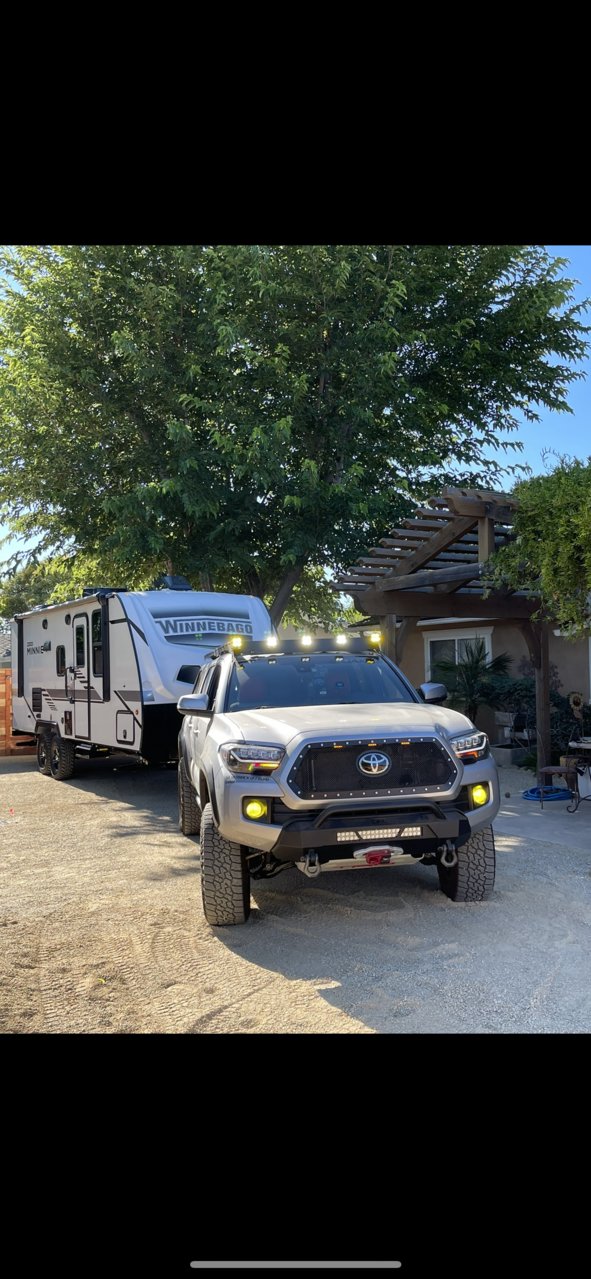

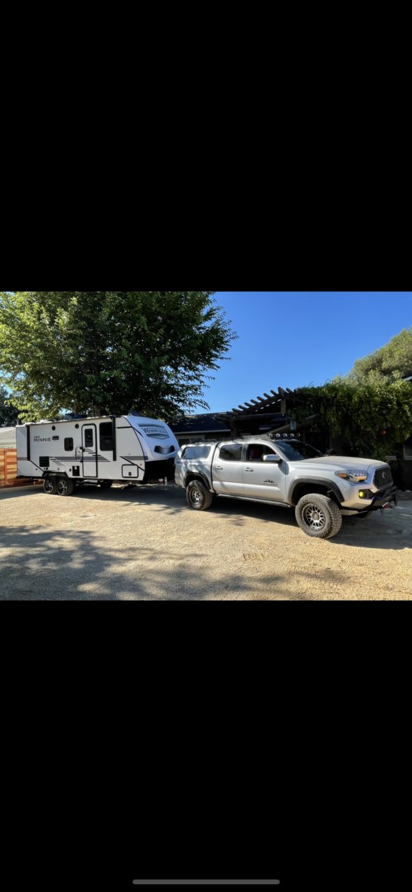

    Agree with you 100%. Most people on here saying a Tacoma can’t do it are the same dipshits that pass you on the freeway going 75mph with a trailer hooked up to them. Yeah you try and do that with a Tacoma you’re better off sticking a fork in a power outlet. (The sign says 3 axles or more 55 MAX for a reason) I have a 2019 TRD OR SB with HD rear springs, 2.5 resi’s front 2.0 resi rear, 32’s, low profile OR bumpers, and I tow a MicroMinnie 2306BHS and the truck does flawlessly. Granted it has a tune and I always use S4 mode with ECT, but long as you pick up on your grades wisely and you have a quality WDH, these trucks can do it comfortably. The only real downside to towing with a midsize is fuel capacity, but otherwise these trucks can haul. Did I mention the truck had a shell, decked drawers, and a RTT on it on my last outing with the trailer? Sure I’m modified but isn’t that why we modify? So we can do things stock folks can’t? This is prior to the trip when I picked up the trailer from service.98D9A72F-F874-445F-8825-6988EFA02C33.jpgC4530BC9-A092-4157-BE15-5B81691F85E3.jpg

    I own a 16 foot 3400lb gross travel trailer and will say 4400lb is a hard no one my 2019 off-road.
