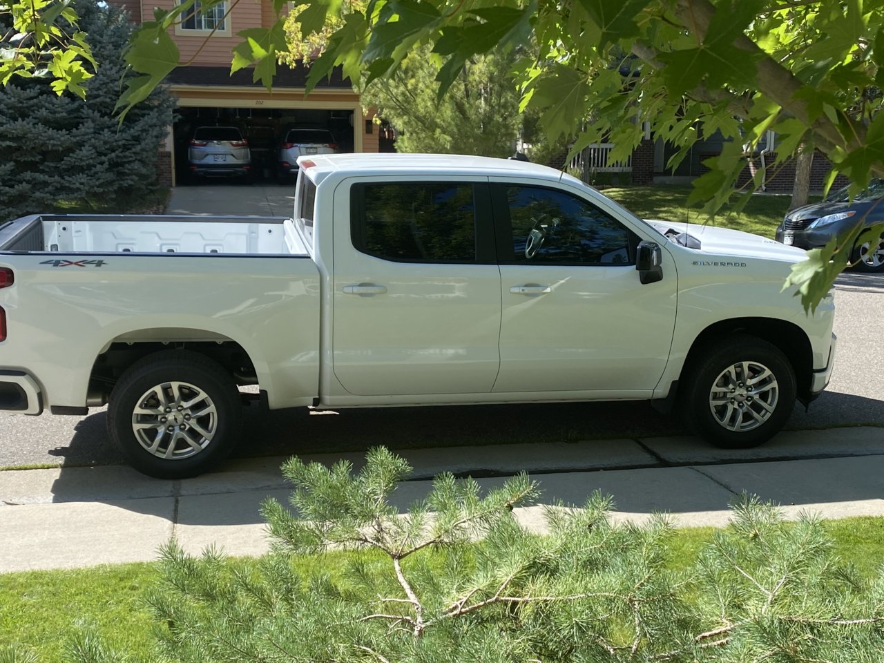

    Don't do It! My trailer is max 5700 lbs, usually 5200. Live in CO and going anywhere, Its rough. Picking up a new truck tomorrow to replace it in fact. Sad to sell it, but, its not a tow vehicle. Everything was maxed out and that was with a 550 tongue weight with WDH. Wife + myself + 3 Dogs with the back seat stripped out.

    Can't wait to tow my trailer now. Way better than anticipated and shouldn't take me 3 hours to decompress afterwords. '
