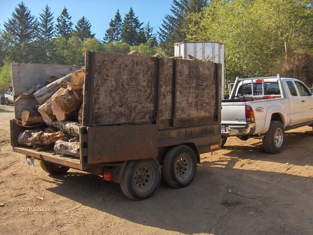

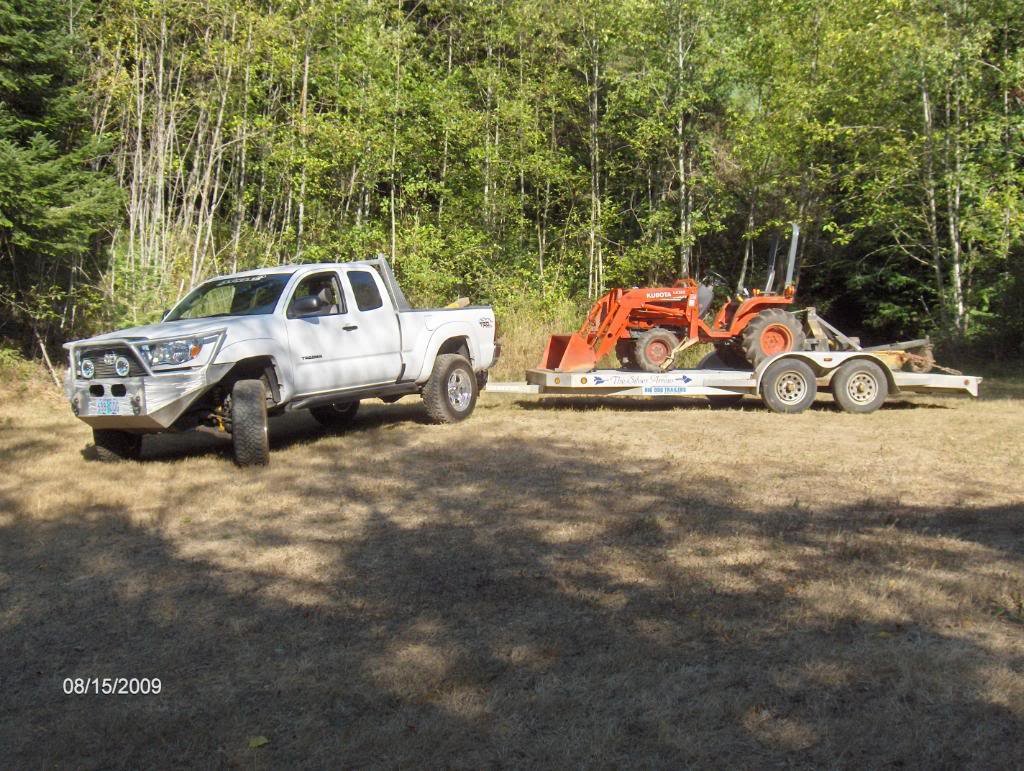

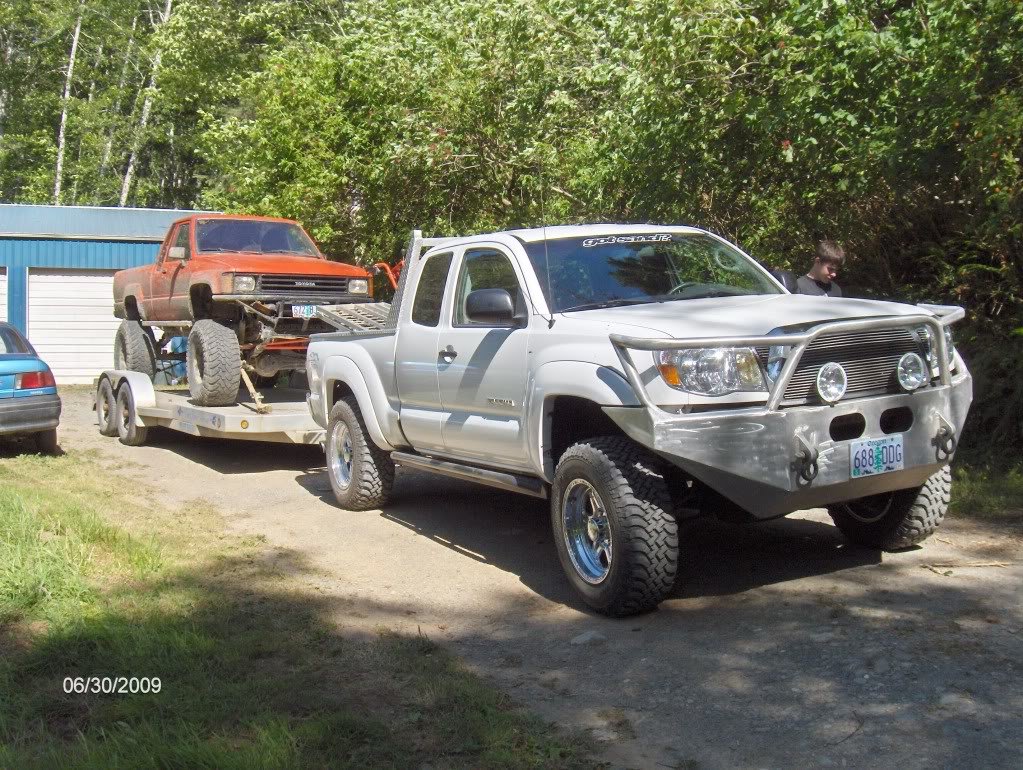

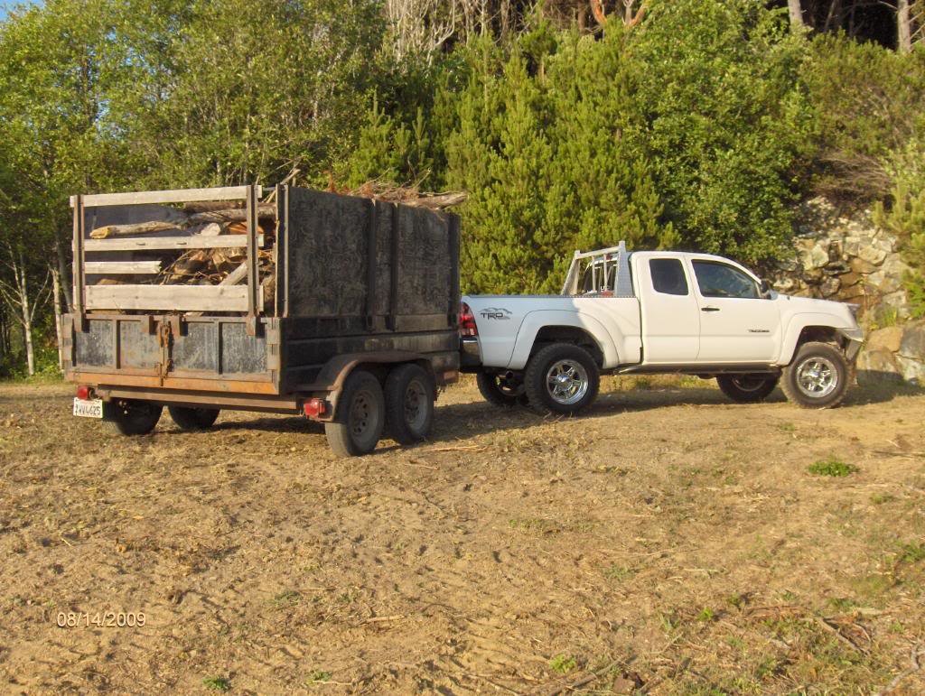

    here's some of the things ive towed with my 4.0L 6 speed. Handles it just fine as long as you dont expect to travel several hundred miles.
    In the last pic, there is about 450lbs in the bed of my truck already so thats why its sitting so low.
