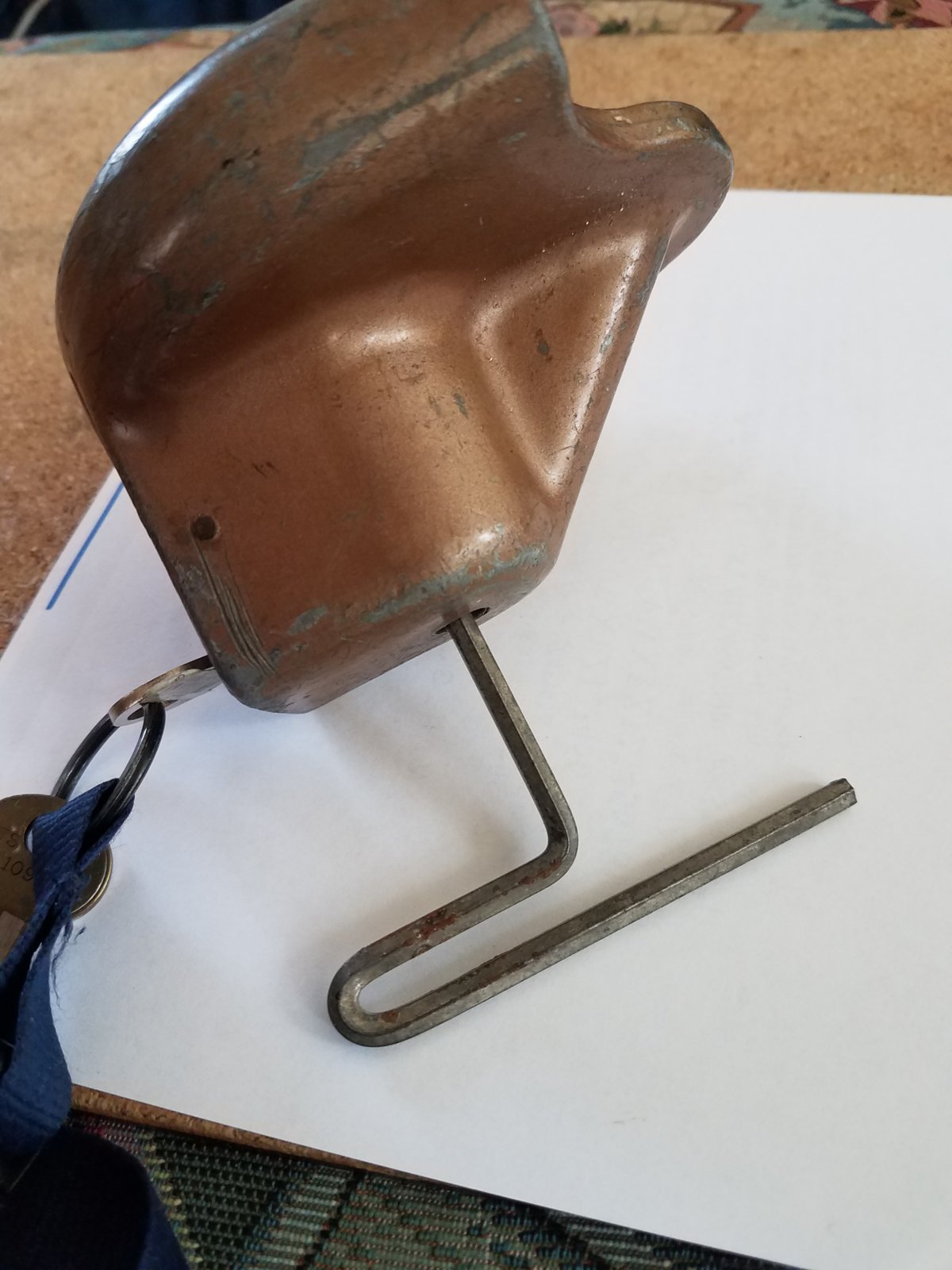

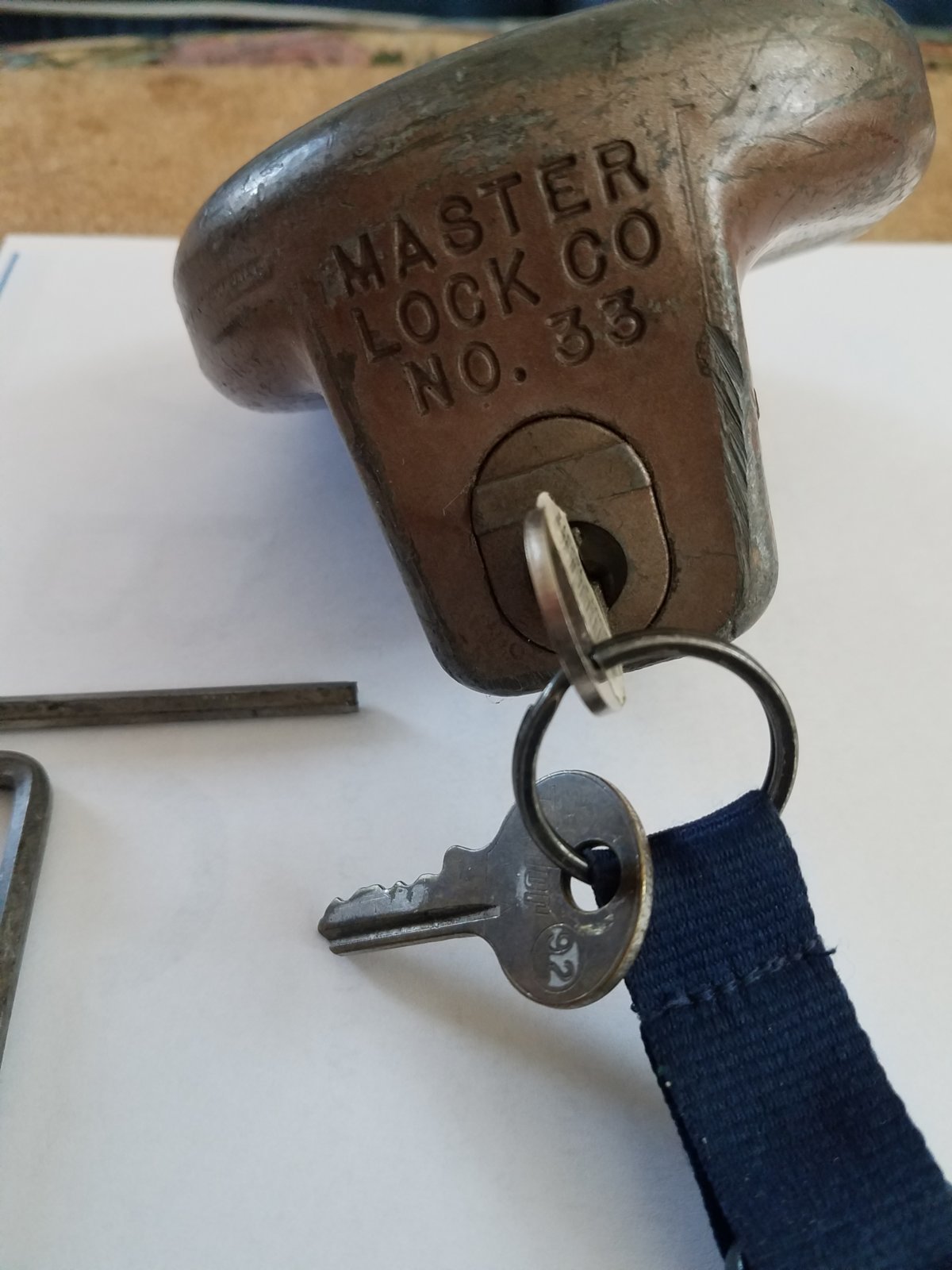

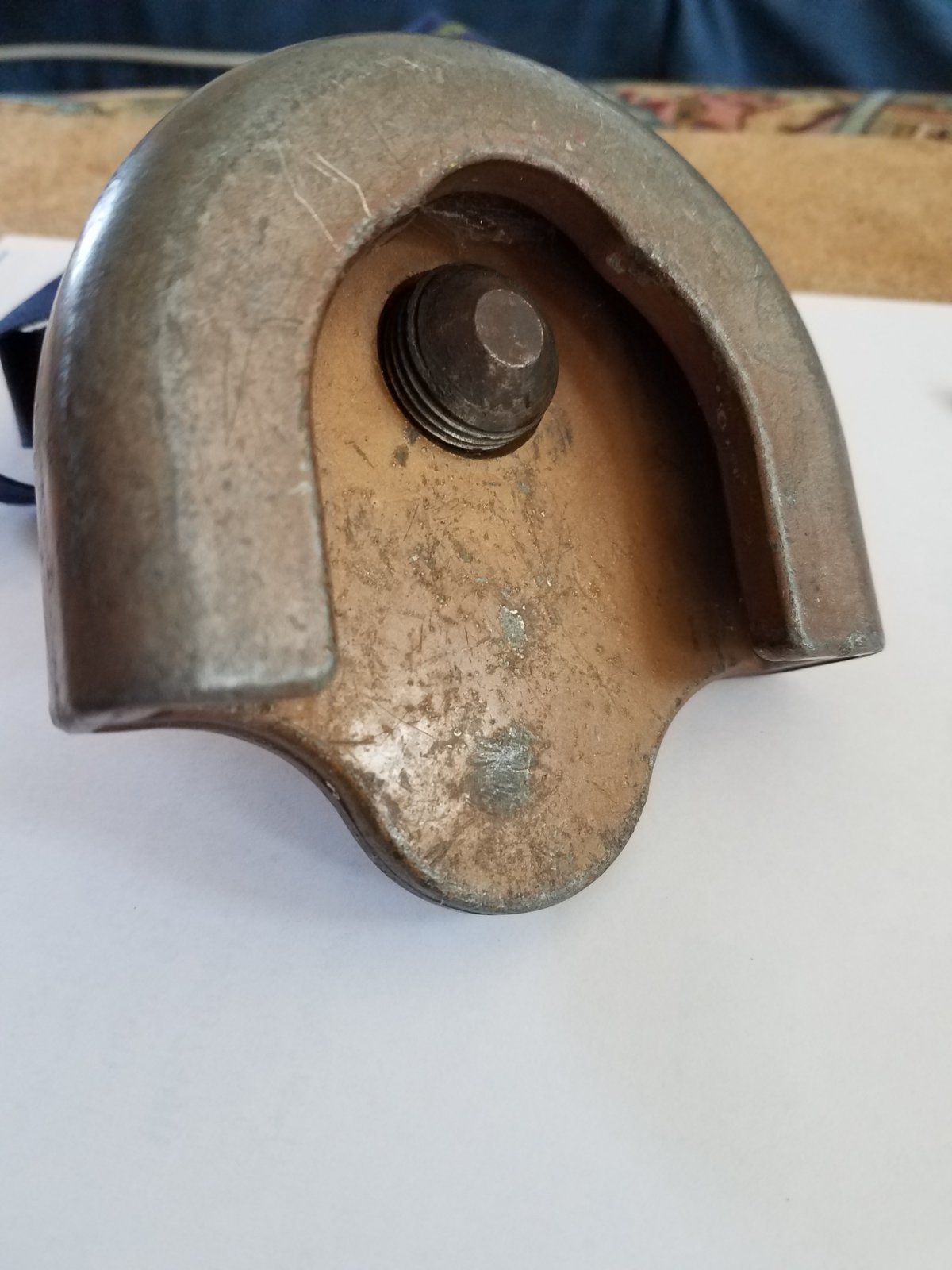

    Not sure if they still make them but Master has/had a hitch lock that slides over the end the trailer hitch itself. There is a hole on the bottom that you insert an allen wrench and turn an internal screw into the trailer frame where the hitch ball would be when towing. When it's tight, it cannot be moved (slid off). There is lock that when you turn it rolls a round metal cylinder to block the hole. You do have to remove the trailer from the hitch ball, but only enough to slide the lock over the end of the hitch to install or remove it. It's made of hardened steel that as you can see doesn't rust. I have had this on various trailers and campers for years. This one is 1-7/8". They had them for all the different sizes of hitches. There is probably a more modern version now. You can also buy locking hitch pins for the draw-bar if you don't want to remove it from the receiver.

    Never came across something that could secure both hitched together either. They have hitch trigger locks, but they always gave the me the impression that they would be easily defeated with a few hits with a sledge: too much play/sloppy fit.
