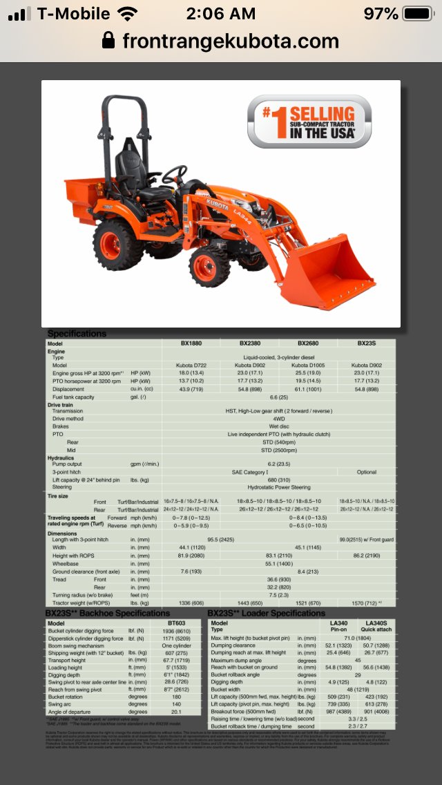

    The dump trailer behind my Tundra was a bit much.
    See about renting a sub-compact tractor or smaller skid steer.

    That might work. I'll check into it. Thanks
