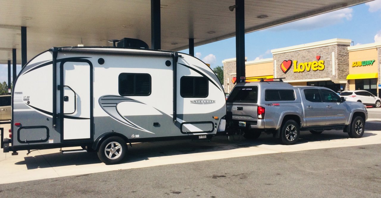

    With this trailer I was at about 3500 empty. Truck has factory tow package. I added Prodigy P2 brake controller, and Wheelers 1.5 AALs. Not shown because this was a very short across town trip is my Fastway E2 WDH. No problems towing without the WDH but it does bounce less with it installed. Especially on highway expansion joints. Btw, Toyota owners manual specifies need for an anti-sway device for any trailer over 2000 lbs. And a WDH for any trailer over 5000 lbs.

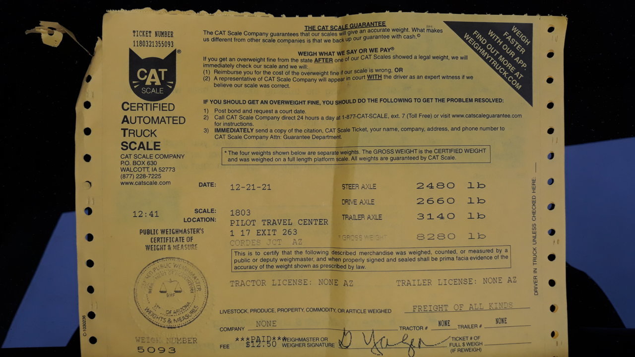

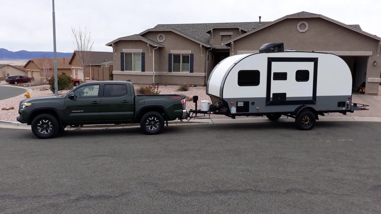

    Redarc brake controller, weight distribution hitch and will be adding sway bar to the mix. Does not sway but why not. Tows my trailer fine, but gets the same gas mileage towing as my Ram 2500 towing a fifth wheel. Trailer is about 3200 dry. The weight ticket is basically dry weight with a battery, propane, 80lbs of tools In bed and 10 gal of water. 20211221_134728.jpg 20211221_134758.jpg
