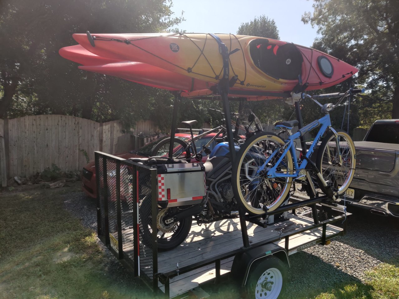

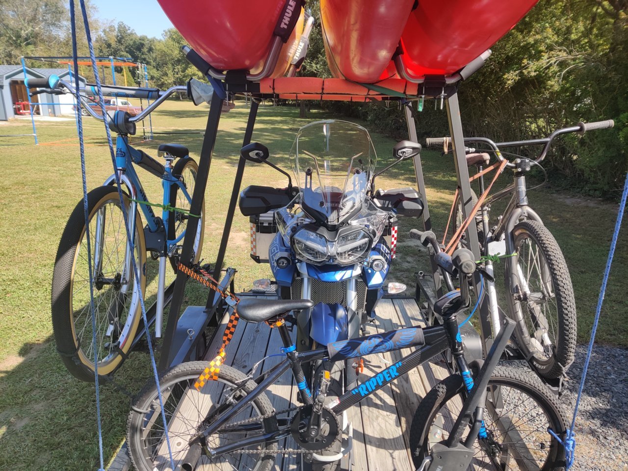

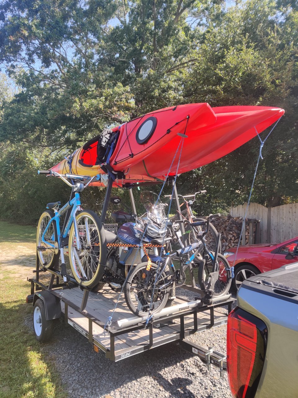

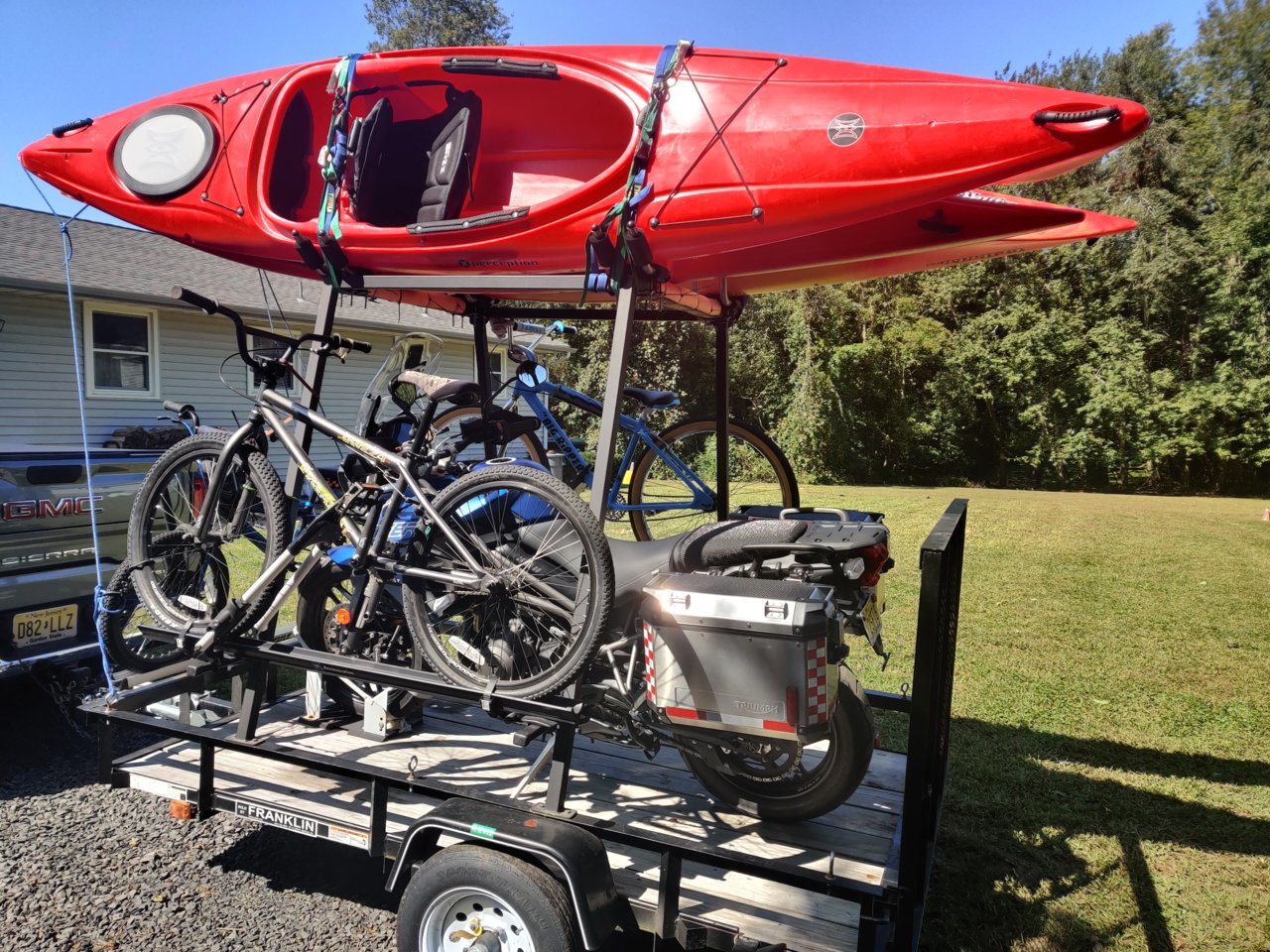

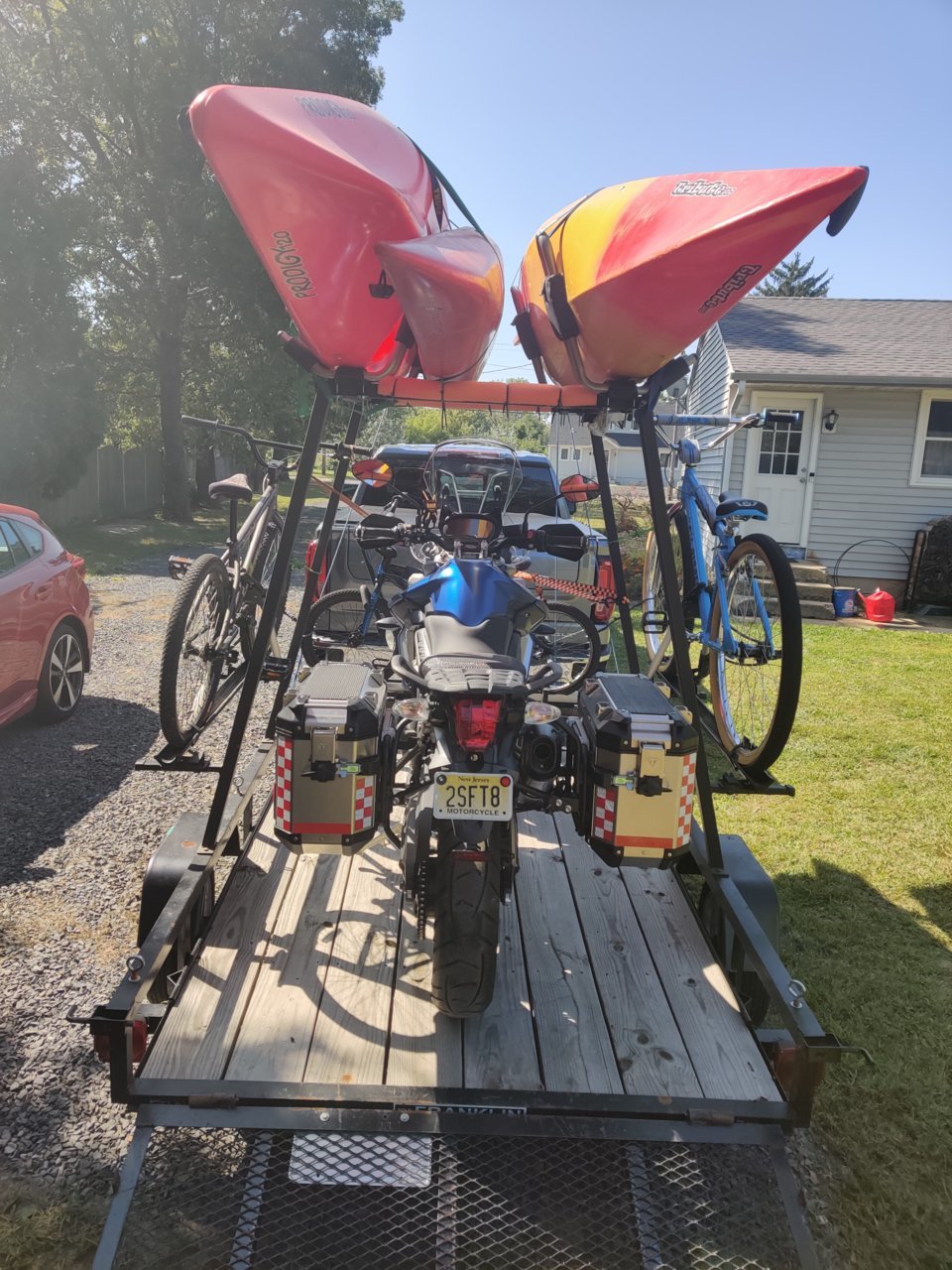

    used to tow this with my tacoma. would use ETC in drive and it didn't hunt anymore then like it did without a trailer. you knew it was there though.. trailer is a 5X8. that trailer of yours is quite a bit heavier then mine... MPG will take a pretty good hit.

    #16

    That is a lot of transportation packed on to one trailer!

  17. May 12, 2021 at 5:49 PM

    566
    joe
    2017 Tacoma double cab TRD Offroad. quicksand in color
    when we go to the in-laws in wilmington ny we have to bring all the toys.. :)

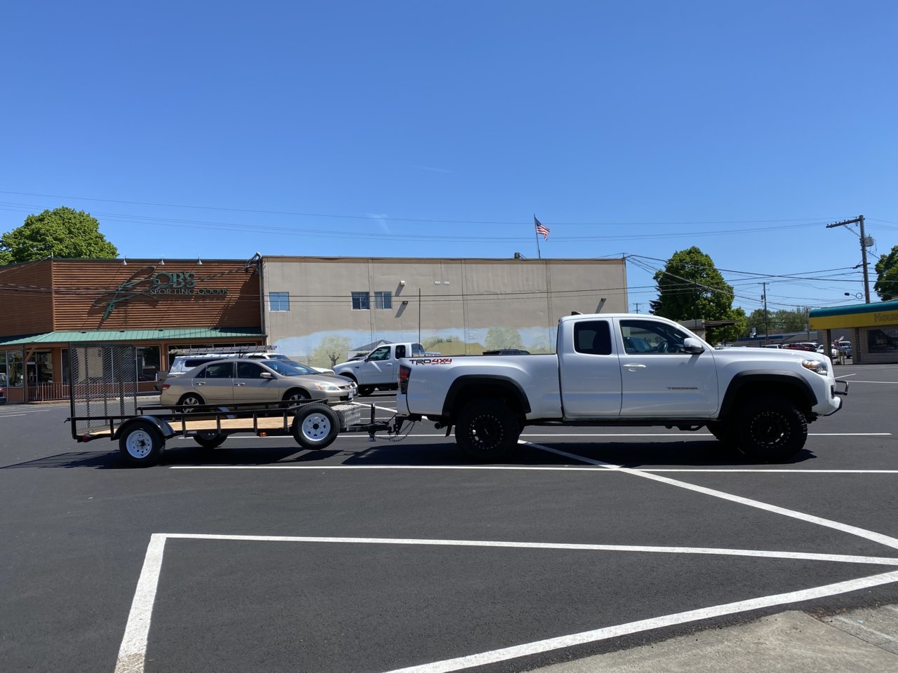

    2 things.
    Get some weight in the trailer if you are hauling it empty one way. Like bags of gravel from a box store, anything. Get a couple hundred pound's to settle the trailer. The empty utility trailer will absolutely bang and jump the whole time.
    Second and BY FAR the most important part, lose the ramp. An empty utility trailer with a 4 ft gate is the worst to tow. I tow a ton, much of it in a utility trailer just like yours. Get a separate ramp or something, but if you keep the tailgate up, you will regret it. My truck hauls 4000 lbs. easier and far more comfortably than an empty trailer with a gate up.
    I also get almost 4 MPG better without the gate vs. with it when hauling it.

    Was going to post just this. Amazed at how much the mesh gates ruin the airflow and kill mpg's. On a long tow I would take the gate off my open trailer and use a ramp to load the trailer. Yea harder to get on/off, but drives with so much less drag. Or if the bed is open, load the bike up in there and drive. Didnt have a hit on mpg with the bike in the bed, and while the OP I'm sure could shame any of us while backing, sometimes its nice to never even have to think about it.

    ^^ What he said. If you notice that trailer behind you, it's drag from that big mesh ramp. Take it off if you can.
