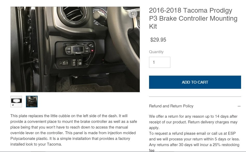

    The Gen 3 has the little cubby space on the left side of the steering wheel that I never use. I was wondering if @mesojdm had already solved this problem with a custom made part for the Tekonsha P3 to mount on the third gen. I saw a custom plate for the P3 to mount on a Tundra but not for our Tacos yet... I'll probably run the camper maybe 1k or so over the whole summer, nothing too crazy.

    Lin
    Link is broked for me ....

    If you find a plate post it up!

    Weird, it is working for me still.
    Here is a quick screen shot.

    The link works- try it again. Thats a nice plate mount! I just drilled a hole using a paddle bit in the rear of my cubby to pass the wires through and wedge the P3 in the cubby, but it does stick out of the cubby a bit. If I decide to sell the truck, I can easily cover the hole with a piece of plastic. Be sure to not hit the wires behind the cubby if you do drill it OP.
    However its mounted, its important to be sure the P3 does not move while driving- it has a sensor for detecting deceleration thats part of the brake control circuit.
