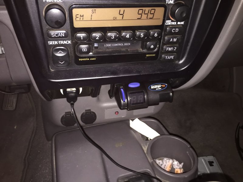

    Alright, it is installed... Since the ash tray never got used that was taken out and the holes for the trailer brake mount fit almost perfectly so its screwed in using the factory holes. Since I usually keep my hand around the shifter area it is a perfect reach to hit the trailer brakes if needed. I just wanted it to look semi-stock :)
    Now I have to the equipment to tow safely, just now need to read and watch youtube videos to make sure I am being safe on the road.

    Thanks for this summary! One question about the proportionals. How do they monitor the brake pedal? On my truck it seems like the first few inches of travel don't do much but further in the brakes are strong. Every other vehicle I've had, the brake pedal only has to start moving for brakes to really engage. In other words in my truck the pedal isn't very firm at first.

    That's exactly where I'd want to mount a controller in my '04! Which one did you get? It doesn't look at all like the one mentioned earlier.

    The one described was on back order for a week and I am impatient so I went with the this one.
    http://www.draw-tite.com/products/b...rake-control/TzaIxkVx1cKszGdLZtTXWecclJjv7kq6
    Wasn't too bad plus on the back all the manufacturing stickers say Tekonsha so it's probably similar-ish.
