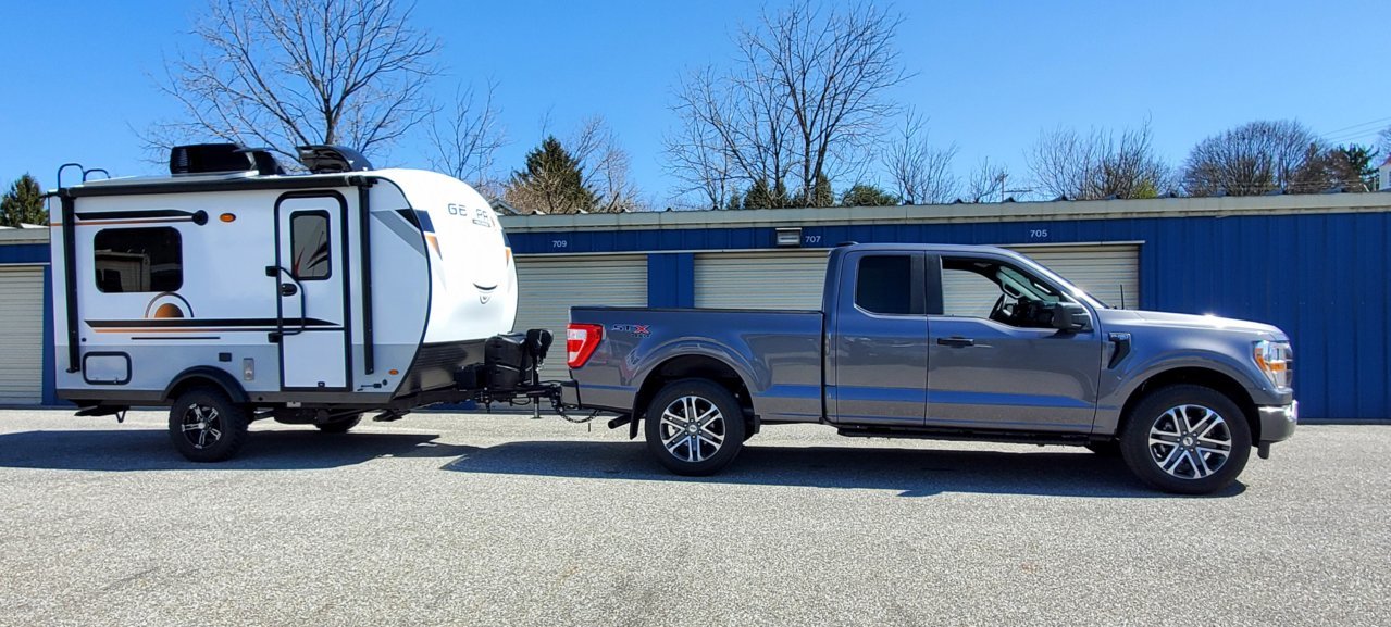

    2020 SR5 Tacoma DCLB 4x4 Red
    I tow in the mountains alot and needed a little more truck than the Tacoma.20210322_134353.jpg
