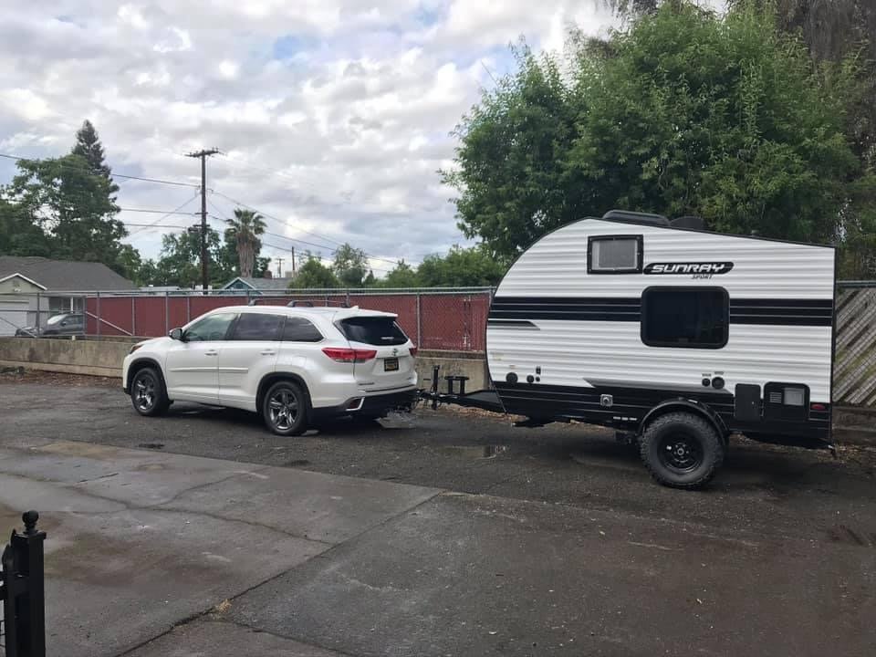

    For reference this is the camper we are getting being towed by a Toyota Highlander

    I've only towed 2000lbs on my utility trailer that is not equipped with brakes and found myself wishing it had them. If I were planning on towing at the full GVWR of 3500lbs of the trailer I would definitely want them. You can allow for extra stopping distance and get by. But in the event of an emergency braking situation it would not be good without trailer brakes.

    i'm only speaking on experience when we were towing via bumper. We got ours and the hitch from the dealer because it was specifically setup by them to ensure the hitch and sway bar all sit level with the trailer hitch. In my opinion, get it from the dealership so they can right fit the whole setup.
