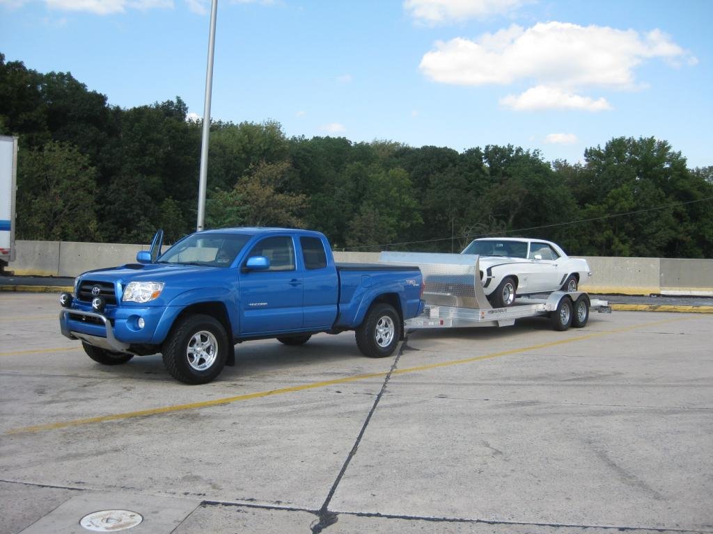

    I know this is not a travel trailer but I use to tow this with my 2006. Car and aluminum trailer right around 5000 pounds. Electric trailer brakes, stock motor, automatic, air bags, TRD intake and exhaust...never had any issues unless pulling a VERY steep grade then I had to bury the pedal. With myself, wife and our gear....never exceeded the rated capacity. I really liked that truck and trailer combination. Hope that helps a little.
    Donald
