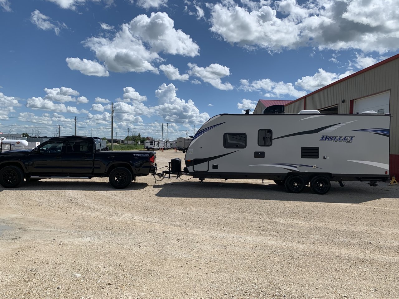

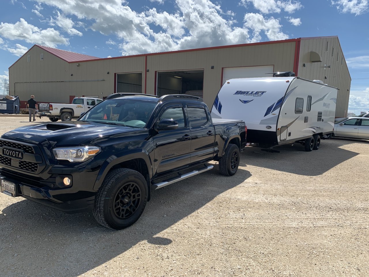

    I did all the homework with pulling a trailer and how much weight I could pull without compromising the truck. I found a 25' trailer that weights 4000 LBS dry and about 4800 to 4900 LBS with my gear and family loaded up. At first the transmission was in learning mode and was constantly revving up down and it didn't help I was driving into a head wind about 45km. On our way home from camping the rpm's stayed at 2900-3000 rpm's all the way home. I was in S4 ECT on. It was a big difference after the learning transmission figure it out. I live on the prairie's where it is flat and have trailer sway bars on. We camped about 4 times since we got it in mid summer. I keep it at 100km and I have no issue's.

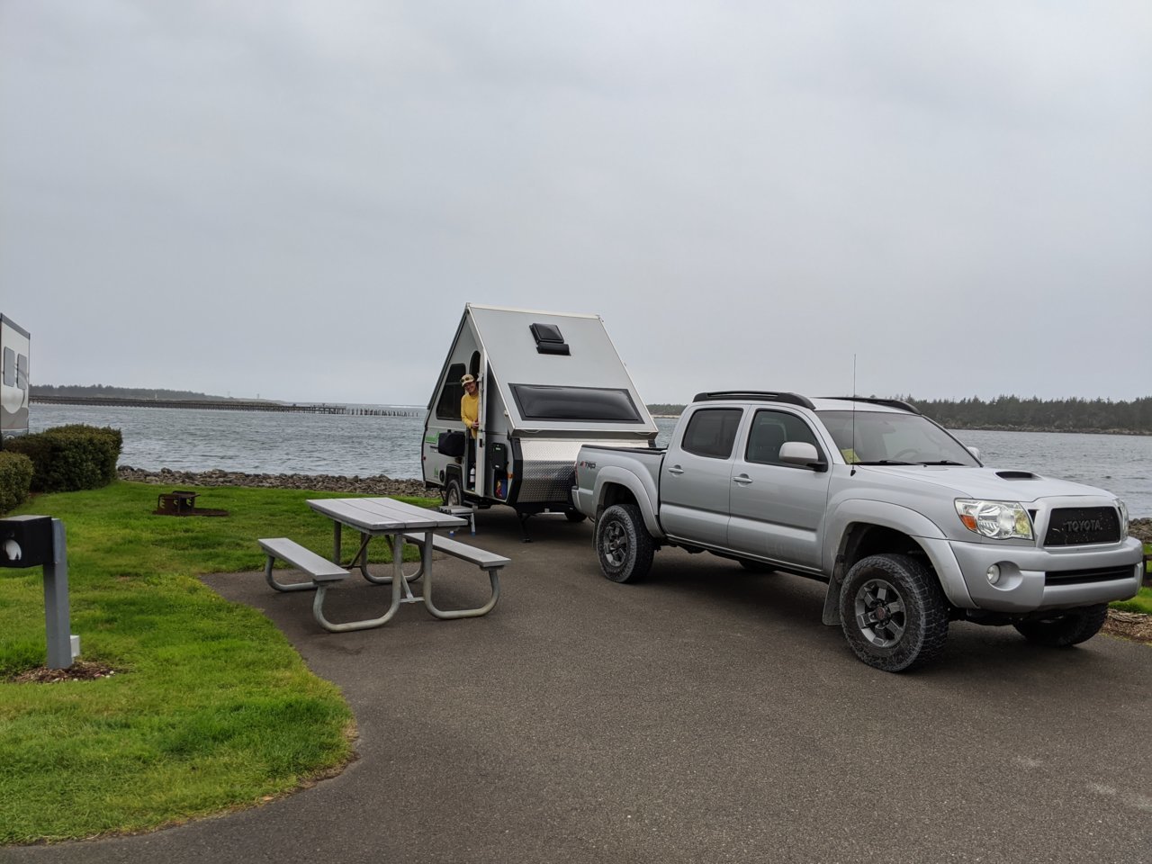

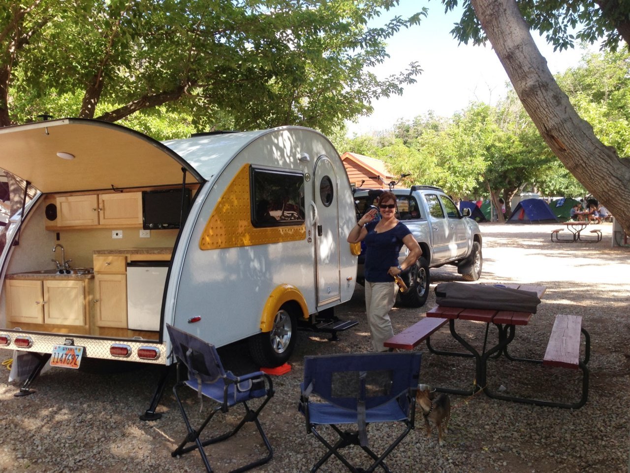

    I had a t@b teardrop and I loathed pulling it. Any kind of breeze or grade and you were lucky to go 60mph.

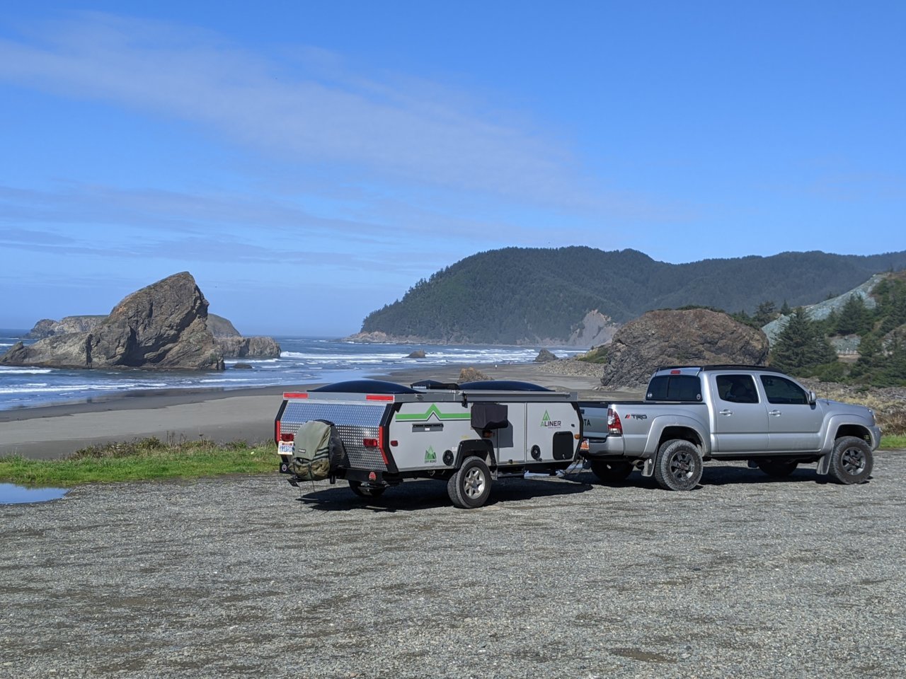

    We replaced it with an Aliner Ranger 12 and I couldn't be happier. It tows a dream. Because it folds flat, I can run freeway speeds and what's more, the A Liner is much nicer to stay in. More room, more practical and more comfortable. Win/win.
    I just said this in another thread, but towing capacity is marketing horeshit. Your tongue weight and payload are what you need to pay attention to. The payload capacity on a tacoma is around 900lbs. That means your passengers, your crap and the tongue weight of the trailer should never exceed that.
    Most people will exceed payload long before they get anywhere near towing capacity.

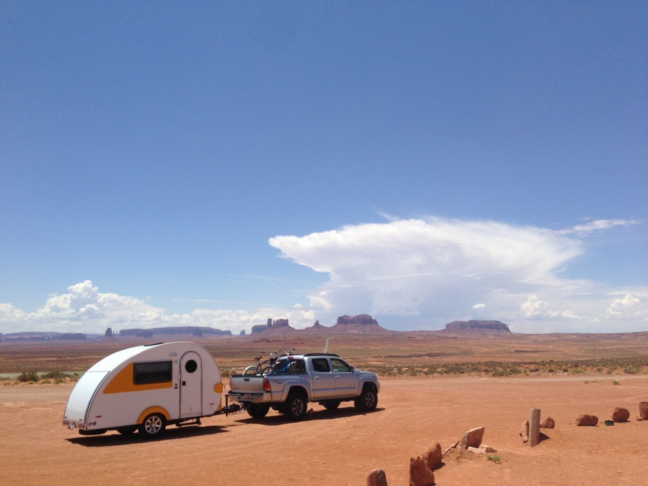

    Found some photos of the Tab. The only thing I liked about it was the outside kitchen, but I also hated that when it came to making coffee on a cold morning.
    But mostly it towed like ass. We took a bath on it, but I was delighted to be rid of it.
