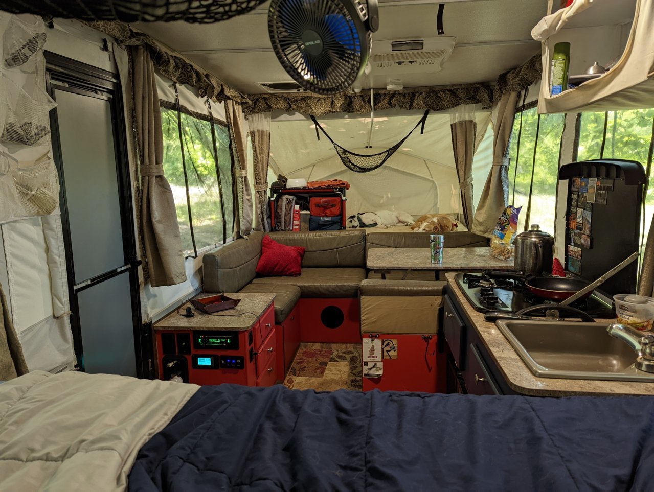

    I tow a pop-up. Aside from the AC box and the porta-dump tank I keep on the roof rack, the trailer sits right in line with the truck's slip stream. I'll outrageously claim that it's more aero than most teardrops.
    And still, S4 in hills or headwind, S5 in flats and tailwind. ECT on, cruise control off. The truck will definitely tell you what you need to be in. Not because of lugging or revving, but because it will constantly gear hunt.
    That's what you really don't want. The constant shifting every few seconds is what heats your transmission, or so I've been told. So let it hang out in 4, crank the radio, and enjoy the slow lane.

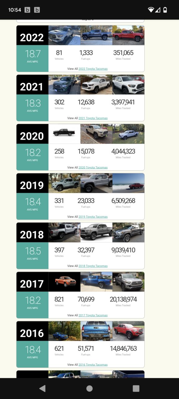

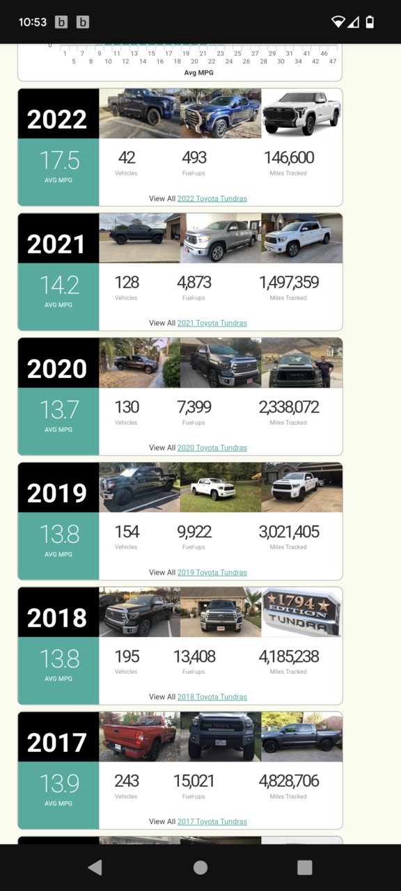

    Actually the new tundra has a lot better mpg than our taco towing or not

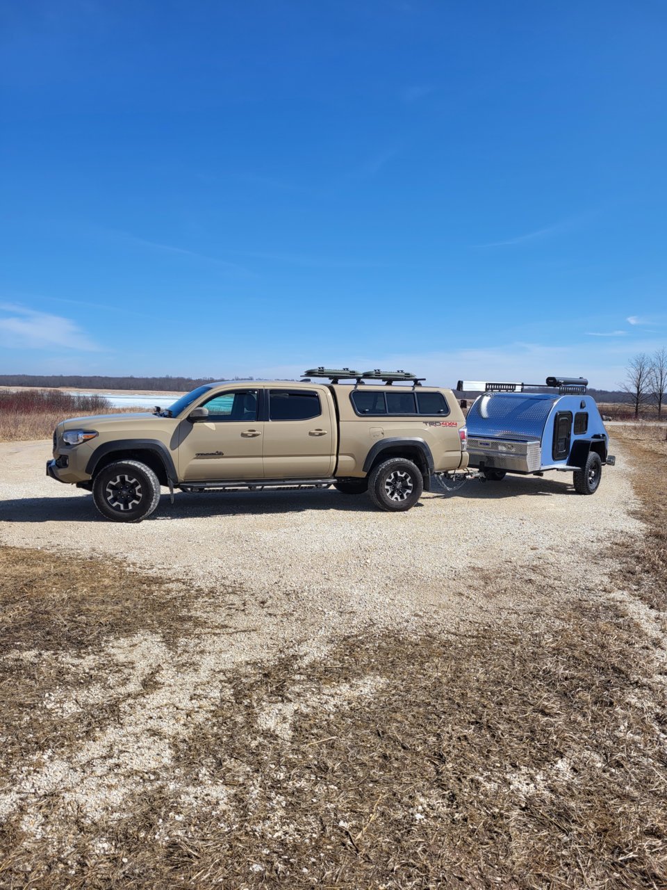

    We Tow a square drop (Off Grid Exposition 2.0) that weights about 1800 dry. It probably ends up somewhere around the 2,300 to 2,600 range after loading.
    We found going up steep hills and fighting the wind it was way handier to keep it in the manual mode in S4 with ECT power on.
    No issues what so ever......so if your is lighter than that, I wouldn't think you'd have issues.

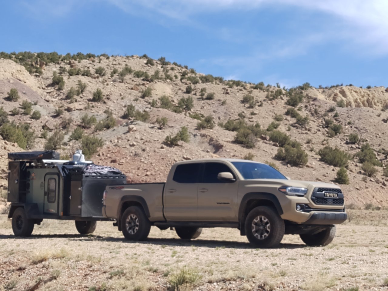

    13.7 mpg average over ~6k mile trip in the last 3 weeks. My trailer is approx 2700 lbs and I was carrying another 400 lb in supplies.
    3100 rpm became very familiar through northern AZ and UT with the climbs and elevation. For the really steep stuff at > 7500ft I just slowed down to 40 mph rather than demand the truck run above 3500 rpm. Back east in VA and NC I've been spoiled by gently rolling hills and can typically get away with 2500 rpm and less for our 6 hour trips to the beach.

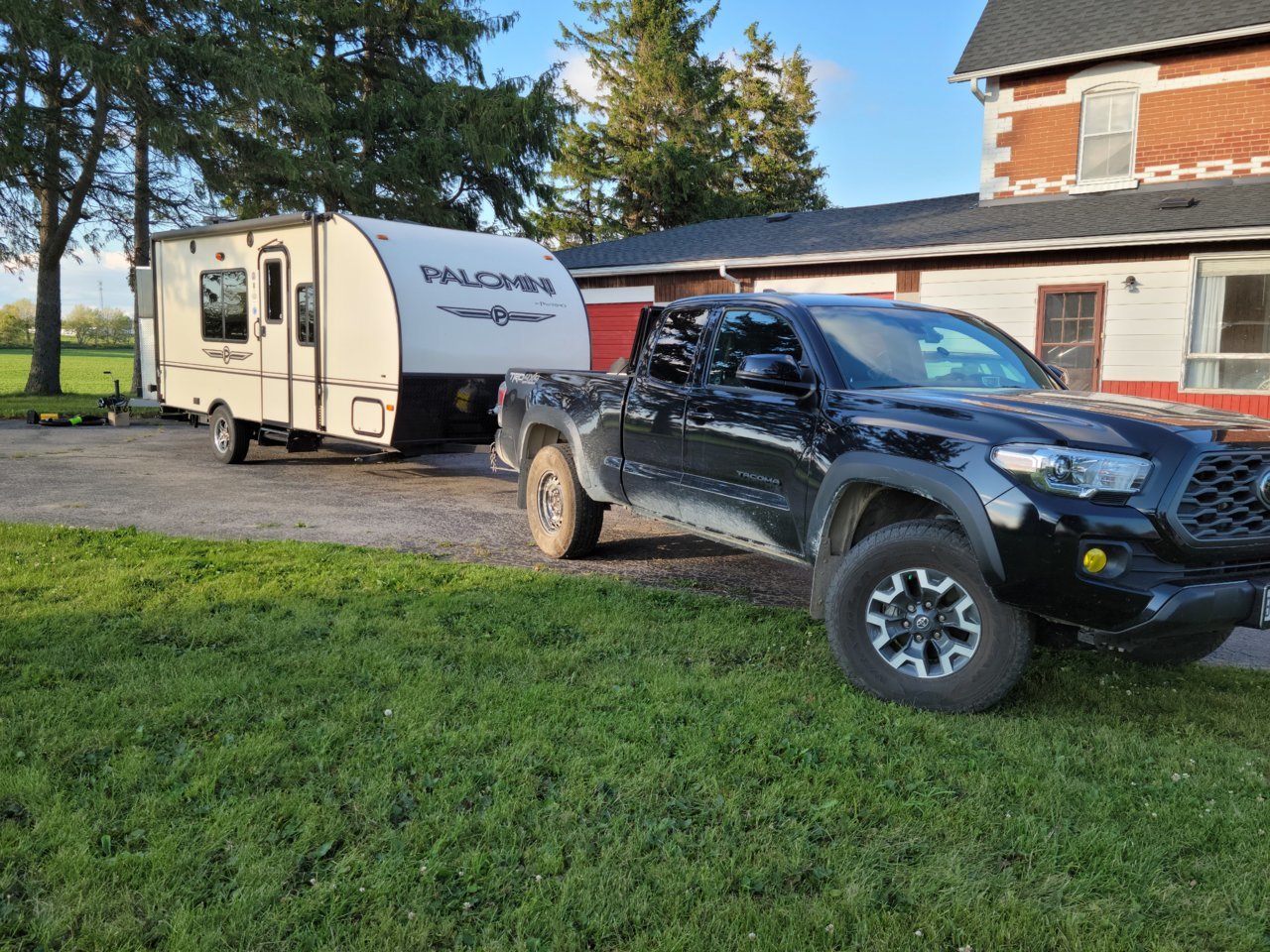

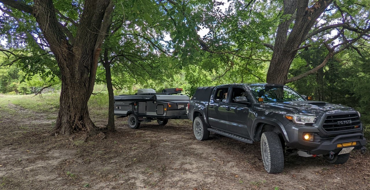

    I tow this. 3500lbs dry. It's always around 13mpg, and i cruise on flats around 2300-2500 rpm @ 60mph. Bump it up to 75 and its 2800-3000. It's also an aerodynamic wall, so there's that. I wouldn't hesitate driving my truck across the country with it. It tows great.
