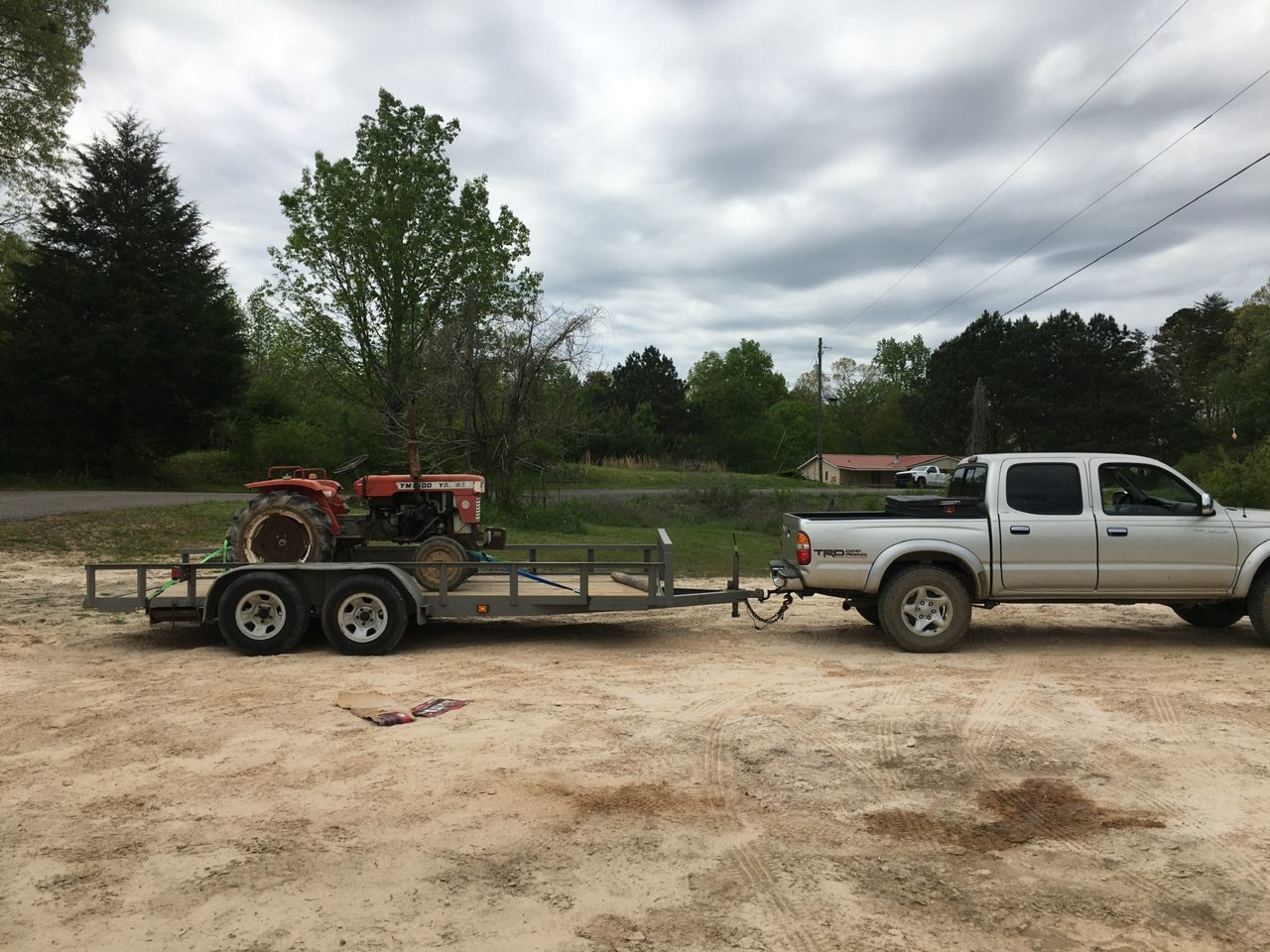

  5. Apr 17, 2021 at 1:45 PM
    #25
    Elijah_j208
    Elijah_j208 New Member
    Mar 23, 2020
    #322823
    4
    Eli
    2004 Toyota Tacoma
    None
    Here’s a picture of my tacoma my 16 foot trailer and my tractor
    Maticuno[OP] likes this.

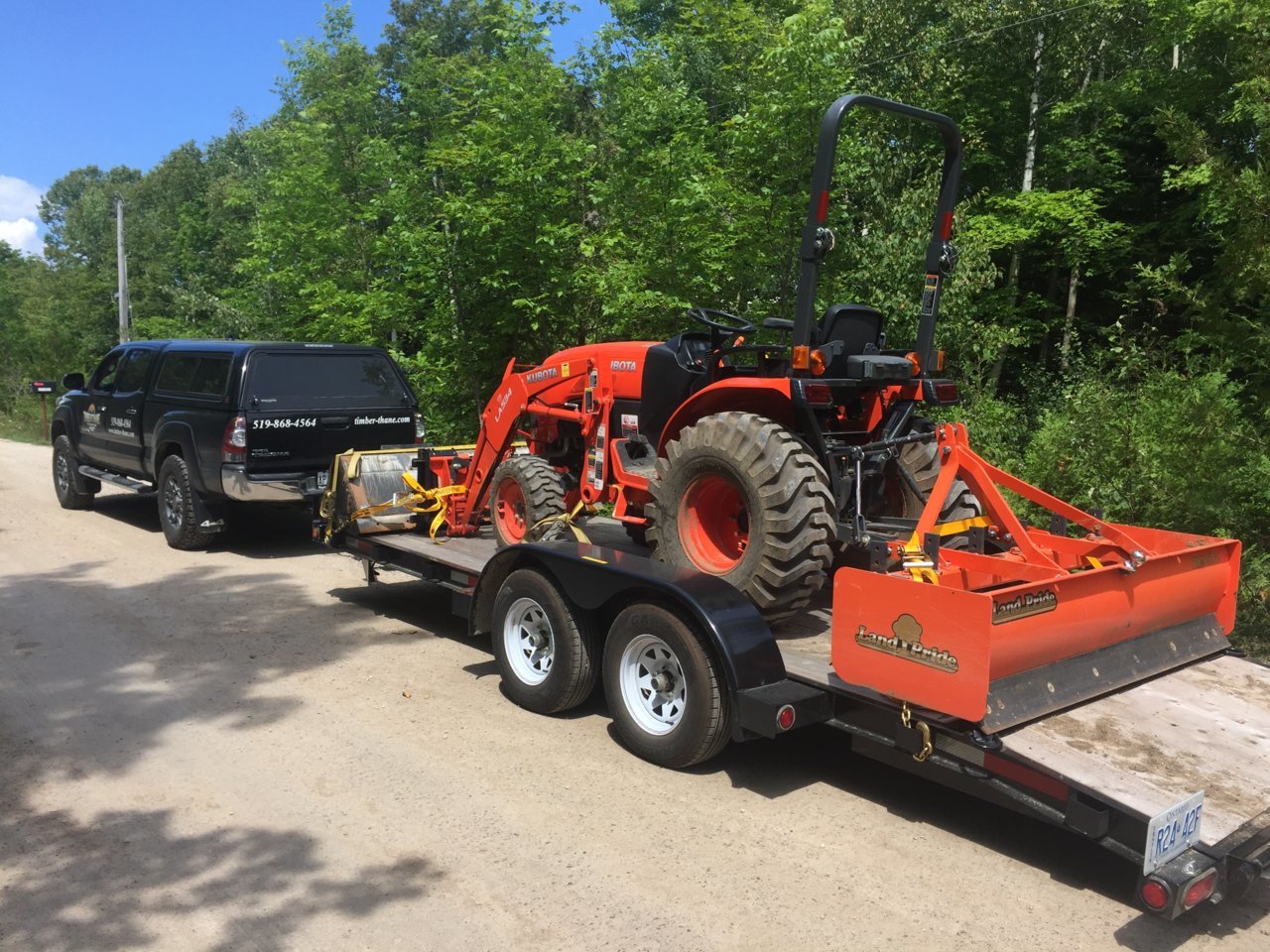

  9. May 21, 2021 at 4:36 AM
    #29
    Steadfast
    Steadfast Well-Known Member
    Apr 22, 2016
    #184952
    1,175
    Thane
    S.W. Ontario Canada
    2013 Limited
    This setup is about 5500 to 6000 lbs and have towed it many times several hours away.
    It doesn't weigh any more than a load of timbers that I regularly haul.
    Spindifferent likes this.
