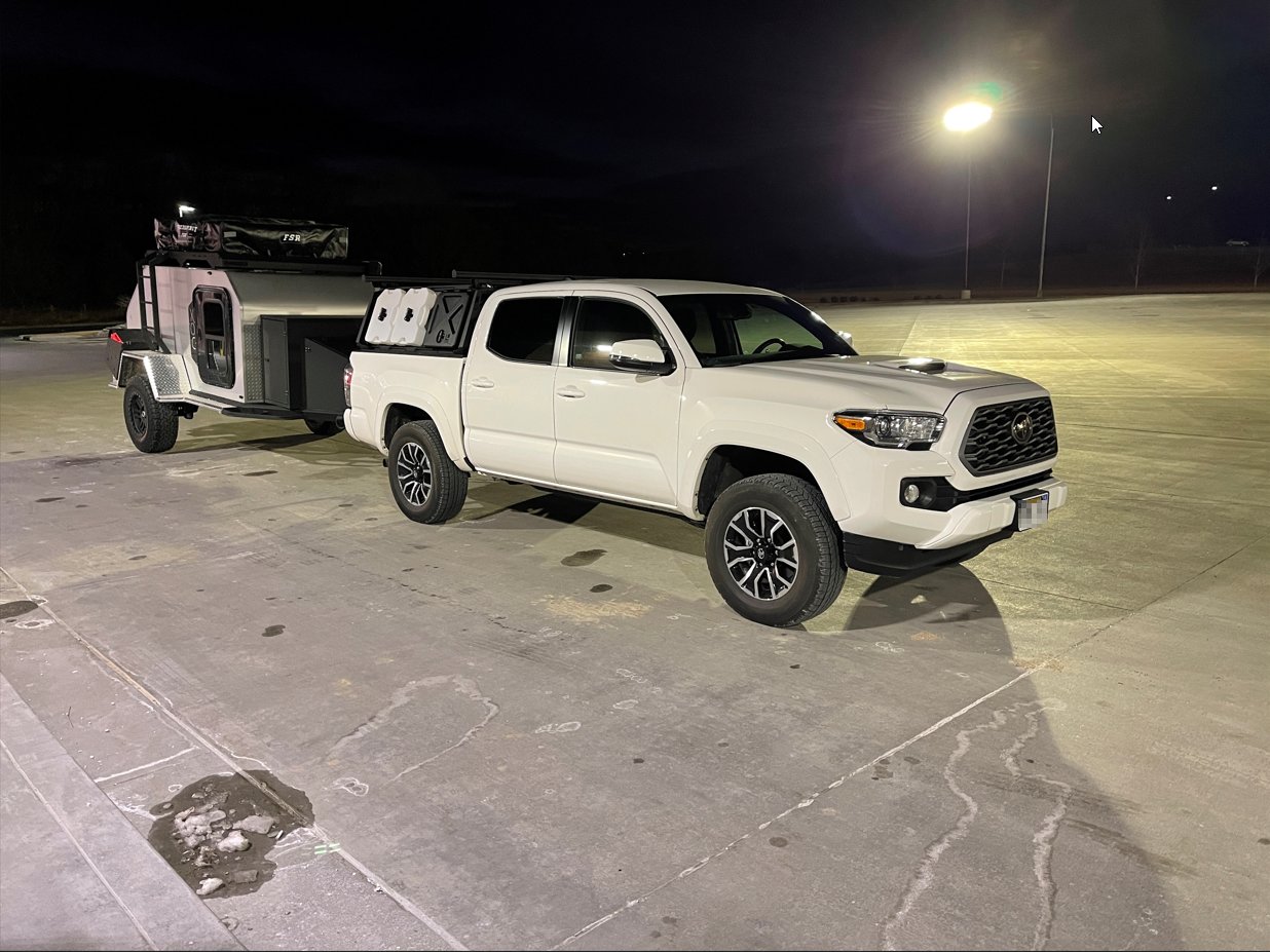

    My recommendations:
    • At 5000 # you will need a brake controller - I am pleased with the Tow Pro Elite from Redarc and they make a harness that plugs directly into the TRD factory harness
    • Some sort of scanner that monitors your TP1 and TP2 temperatures is critical (in my opinion) for towing so you can see - in real time - how your transmission temperatures are changing based on driving conditions. I have a scan gauge 2 and like it, but there are other options that members here have had good experiences with.
    • You may want to consider leveling bags or helper springs to keep your Taco level - I installed a set of Hellwig 981s for a few hundred bucks (self install).
    • Head to a local truck stop, fill up, and weigh your Taco in its current configuration so you have a good baseline of what your numbers are before you get a trailer... when you get the trailer head back and be sure to re-weigh in the same conditions (full tank of fuel) so you can compare. Performance numbers will be a moving target unless you have a solid basis of comparison.
    Other than the above, If it were me, I would just wait to see how the trailer towed my first few trips.
    I tow a Vorsheer XOC off-road trailer which is 15' but is damn heavy because it is built to handle the loads off-roading will place on it. It is a 3500 GVWR trailer and I have been pleased with my '21 Auto DCSB TRD Sport towing through the Colorado mountains. Where I am disappointed is on long flat grades (I-80 from Colorado to Omaha) the stock gearing and the 3.5 V6 just cannot handle 70 - 75 Mph in S5 on a flat grade with a headwind. I ended up just leaving it in S4 at 70 Mph which kept my trans temps below 200 F and my RPMs at ~ 2800 - 3000 which put me at 10 - 12 MPG. That is on stock wheels and tires but I do have weight in the decked drawers and a leitner rack with gear pods.
    A 4.88 or 5.29 re-gear is in my future as well as a transmission cooler w/ fans. I think the re-gear will fix a lot of my towing issues and will let me leverage the overdrive gears on the freeway more. Especially since I want to go with 285s which will only magnify the issue.
    Some notes:
    • I run a max coupler, fully articulating hitch since it is an off-road trailer and have had zero issues through the mountains, on the freeway at 70+ Mph, and in the city. My trailer is about 10' tall with the roof top tent. You may consider a Hensley Arrow weight distribution hitch (or similar) if your trailer is taller and gets pushed around.
    • Check out Tales of Wanderlust on YouTube. That girl towed a base camp behind a 4 Runner for years and just recently upgraded to a Tundra for the additional cargo capacity. She successfully towed an Airstream for 4 years without issue.
    • Make sure you take all advice here (including mine) with a grain of salt.... ask everyone chiming in to post pics of what they tow and where... when I was researching I found a lot of advice from people who were just parroting what they heard from others and had never towed with their Taco. There is plenty of wisdom here on TW but there are also a lot of armchair experts so discernment is key. Not disparaging others, just trust but verify is all I am saying.
    <Pic 1 - this past weekend after fueling up at a QT truck stop>
    < Pic 2 - this was a few weeks ago but the truck is configured the same in the pic above. I'm running dry since temps are still below freezing so this is without the 31 gallons of water my trailer can handle. I fit both axles of the Taco on the first scale so keep in mind about 400 lbs of my Axle 1 weight is tongue weight from the trailer. Next time I go I need to be sure to get each axle on its own scale so I can get front, rear, and trailer weights separated.>
    Lando883[QUOTED][OP] likes this.
