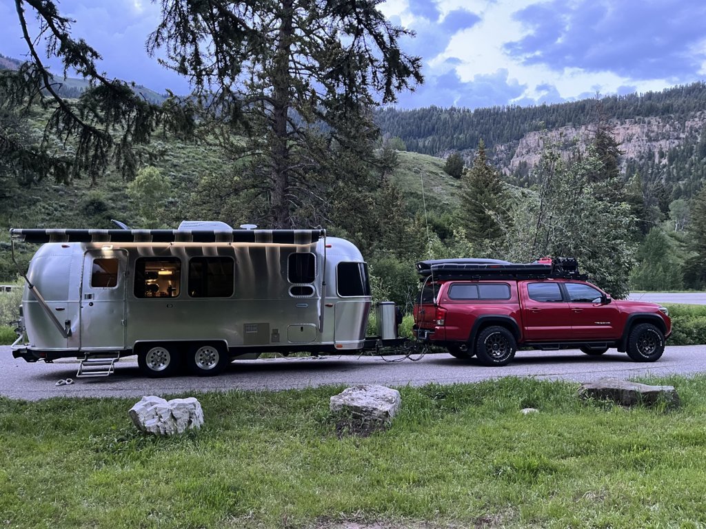

    Leer XR100; Bed Rug; Yakima Sky Box; Yakima Fishing Box; Truck Vault; Mole Panels (Bed & Cab); SCS Ray 10 (17"); DV8 Front Bumper; Uniden Bear Tracker 885 Radio; Helwig 990 Helper Springs; Meso Custom Tail Lights (rear); LED Low Beam Bulbs Trailering: Voyager Rear Camera, Guta TPMS Systems, Direc Link Brake Controller for Airstream Travel Trailer / Interstate Cargo Trailer
    Globetrotter (23')
    TacoManOne[QUOTED] likes this.

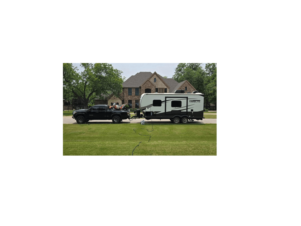

    Bring extra undies otherwise you gonna be selling your truck with brown stained seats like this guy.. xP
    Freshen up all maintenance items. Oil, fuilds, oils, brakes, wipers etc.. Trailer brake controller and beef up the Rear suspension. Keep your payload and weight distribution in check. I also noticed higher psi in the rear tires kept things more stable. From 32psi to 40psi. It felt much better.
    Take it easy and enjoy the time together. I had the best time with my family and I hope you do too.

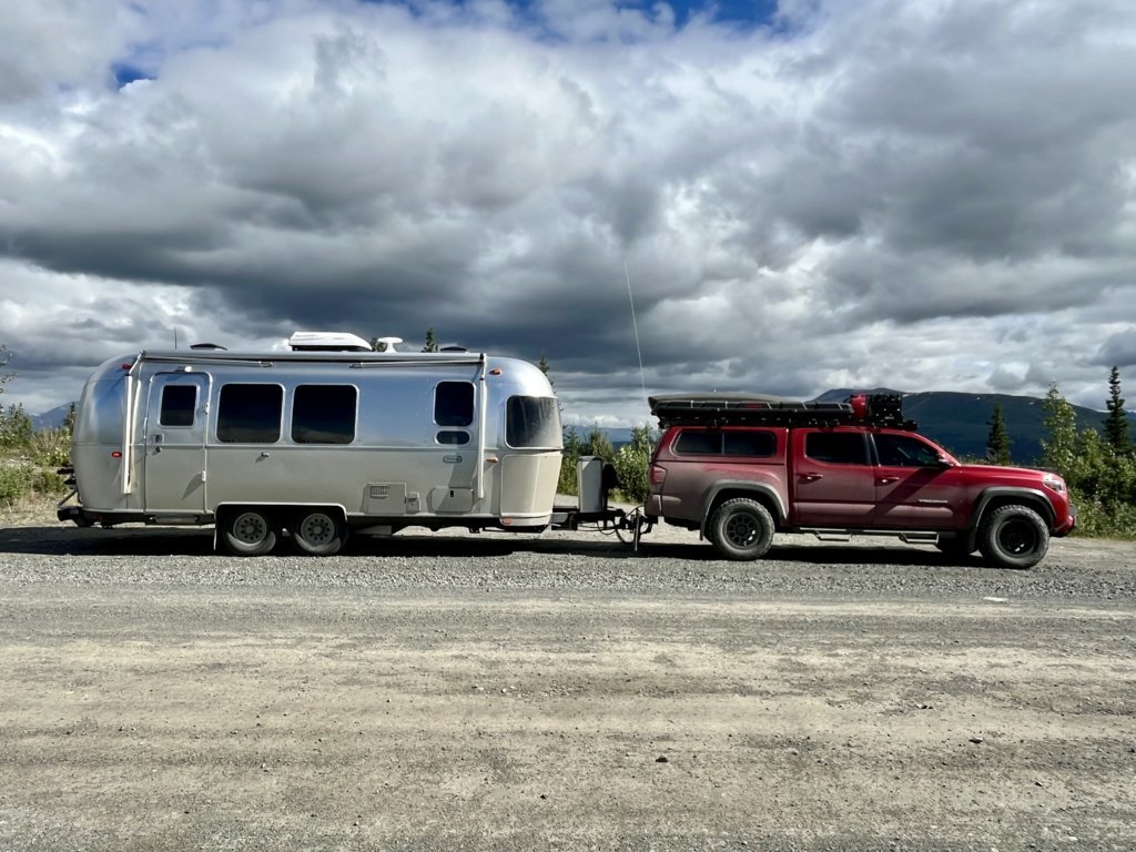

    As others have mentioned, others who choose to tow with their Toyota Tacoma: It tows well, given its capabilities.
    My truck gets anywhere from single digits (7-9) to 12-14 mpg, when I tow my Airstream travel trailer.
    With a Ford F-150 in previous years, towing a similar weight Airstream, got the same mileage. Same experience with winds in those areas of North America prone to that.
    When I tow, the cab has three people: Myself, my spouse, and our daughter. The bed of the truck has a "vault", topper, roof rack, etc... The only modification I have made is to add a "helper spring".
    Whether I towed with a F-150 and a larger engine, or this truck with its V6 engine, I do not exceed 65mph when I tow. Any trailer. On this truck and trailer, I use the Blue-OX weight distribution and sway control. On the previous truck, the Ford with the 25' Airstream, I used the Reese dual cam... This truck (Toyota and 23' Airstream) tow better in that regard, but that has more to do with the weight distribution and sway control system.
    Of course, brake control and tire pressure monitoring is additional because Toyota did not include that with the towing package on this model and year of Tacoma. No big deal.
    Take your time regardless what you tow, how far you travel, wherever you go. Just because a truck has the ability to muscle its way to full highway speeds, does not mean that is the wisest thing to do. Take your time and enjoy the travel.
