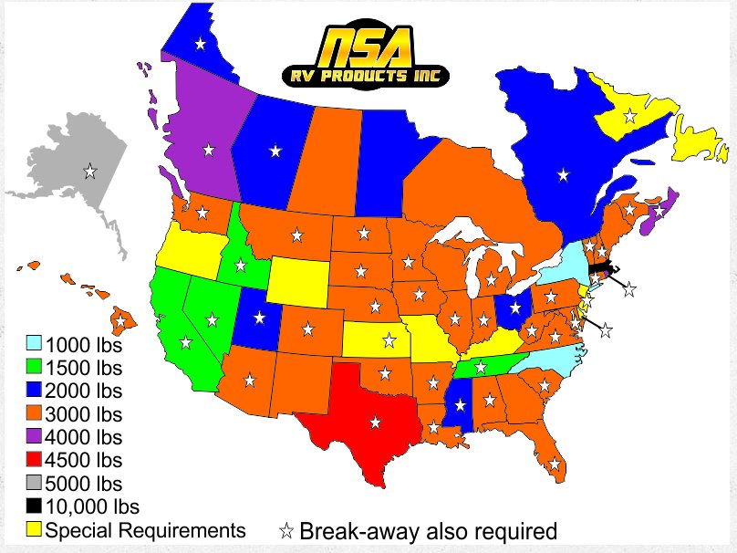

    Without trailer brakes it is Limited to 1,000 lbs max for trailer and cargo. Per Tacoma and Tundra Specs ...

    Here you can tow at least 3500 lbs without brakes. Tacomas without tow package can tow up to 3500 lbs.
  10. Apr 21, 2020 at 8:41 AM
    Rock Lobster
    Rock Lobster Thread Derailer
    Dec 14, 2018
    #275833
    12,138
    Dee Eff Dub
    Sport Crew represent
    They have to go by the most restrictive law that they market those vehicles to. Not that I disagree with that law. I like having brakes on my small trailer...
    mbarbay and Crooked Beat like this.
  11. Apr 21, 2020 at 9:09 AM
    Tiger109
    Tiger109 Well-Known Member
    Aug 18, 2019
    #302588
    136
    Louisiana
    2020 TRD OR
    If I'm understanding this correctly, then an F-350 would have a 1000 lb. What a States restrictions are, does not mean that's the actual payload or towing capacity of a vehicle
  12. Apr 21, 2020 at 9:21 AM
    Rock Lobster
    Dec 14, 2018
    #275833
    12,138
    Dee Eff Dub
    Sort of. The chart shows each state's regs on when a trailer is required to run brakes. Tow capacities are a lengthy, hairy subject on their own, as almost every manufacturer uses a different method to determine that. However, when it comes to advertising the braked/unbraked capacity, they should choose the more restrictive of the following two values: what the capacity is as designed, vs. capacity as regulated. Thats what keeps the company lawyers happy. If Toyota wrote in its manual an unbraked tow capacity at 3,000 pounds for example, New York residents could possibly sue for damages if shit went wrong. Maybe not win necessarily, but their lawsuit wouldn't get thrown out either.

    I'm 50 years old I work in the oil field, I have been Towing and Hauling stuff commercially my whole life. No manufacturer goes by that criteria. My company truck is a 2020 F250. You will never find anywhere that a truck manufacturer tells you it's towing capacity is based off of an individual state law. It is my burden to know what the individual state laws are when towing a trailer.
    Canufixit and abodyjoe like this.
  15. Apr 21, 2020 at 10:09 AM
    Rock Lobster
    Dec 14, 2018
    #275833
    12,138
    Dee Eff Dub
    Just to make sure we are talking about the same thing, I'm not talking about tow capacity, I'm talking about the weird blurb in the manual about unbraked tow capacity. And yes, all manufacturers know how the regs apply to their vehicles and write the manuals accordingly. Some are just phrased much better than Toyota's.
    Here is the 2020 F250 owner's manual:
    Thats how it should be written, but Toyota instead chose to write theirs by the tightest restriction they market to. Probably because the F250 is capable of stopping a 5000 pound load without trailer brakes. The Tacoma cant do that (safely).

    I see what you're saying, but his question was the capability of the truck not what New York and North Carolina say.
