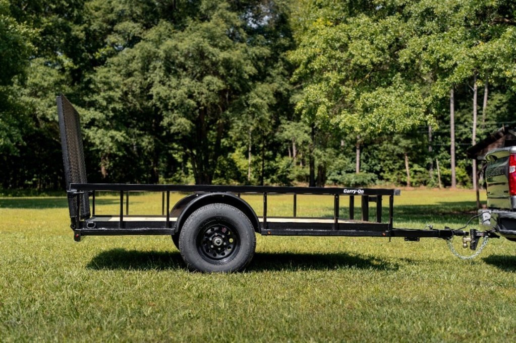

    Check your trailer if you haven’t, most 6x10 trailers don’t have the axles or brakes required for a 6000lb load.

    it's a rental from Tractor Supply.

    That can’t even handle a single 3000lb pallet. You need to rent a real trailer from an equipment rental company.

    Based on what ive looked at on their website, the trailers they show for 6x10 are all around 2k lb capacity. Id see if you can just rent a uhaul, let them load it on the dock, and then just unload by hand.

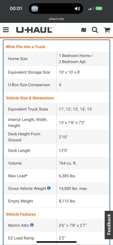

    Thanks guys. I'll have to go rent a box truck.

    Id check with the place youre buying from first to make sure its doable. The 15' uhaul is about 6.3k capacity but I forgot they probably have a lower deck height. Im sure theres other box trucks you can rent though.

    I think the 15' should work.

    The trailer pictured, the 10 footer, cannot accept 2 pallets from a forklift. Or anything loaded else by forklift, unless it is a slung load.

    As others have said, one pallet would overload the rental trailer by about 33% and probably damage it.
    Also a 4000 pound trailer without brakes would not make for an enjoyable or safe trip.
